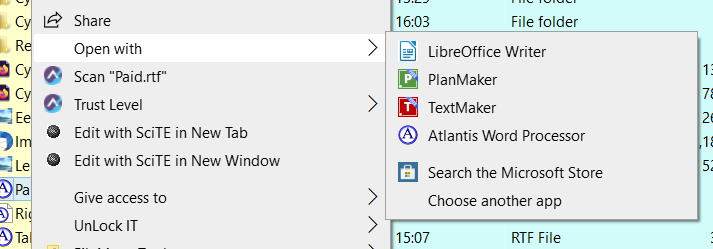

    I found a program offered via Open With for rtf that was inappropriate. (Presumably the authors had configured the option incorrectly. Here is before I deleted it with Default Programs Editor:
    How to Remove Incorrectly Added Apps from the "Open With" Menu in Windows 294461d1598363438t-can-i-customize-list-suggest-apps-open-menu-before.png

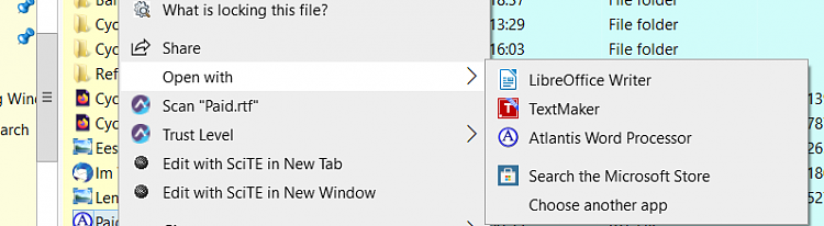

    And after:
    How to Remove Incorrectly Added Apps from the "Open With" Menu in Windows 294462d1598363455t-can-i-customize-list-suggest-apps-open-menu-after.png
    Can you see the difference?
    Hope that's what you're looking for.
