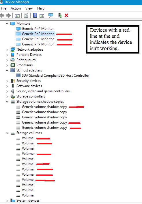

    Currently, this hardware device is not connected in Device Manager
    I was having some trouble with device on my computer and went into device manager to find out if the device is working properly in device manager and it wasn't so I fixed it, but in device manager under certain devices are showing multiple devices with the same name (See below) with only a few working and the other stating "Currently, this hardware device is not connected to the computer. (Code 45), To fix this problem, reconnect this hardware device to the computer."
    How to solve gpu error: Currently, this hardware device is not connected to the computer.... 209668d1540347060t-currently-hardware-device-not-connected-device-manager-device-manager.png
    My computer is working fine, so what is causing this to happen and should I be worried about this?
    As Helmut says, every device that was ever connected will be listed if you tick 'show hidden devices' in Device Manager, ones that are not connected currently will be greyed-out. Under Disk drives I can see every usb stick or external HDD I've ever used.
    It is safe to right-click on such a greyed-out device and uninstall it, but just leaving it there will have no ill effects.
