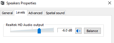

    I don't know precisely how the math goes, but it goes something like this. Windows default volume is -6 dB (66 on the 100 scale). Right click to get dB.

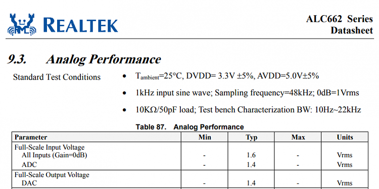

    Then you look at the particular audio chipset you have on your computer, then look at the datasheet to look at the maximum output voltage.
    how to stop windows 10 audio output volume resetting to 100% 399164d1697400296t-output-volume-s2.png

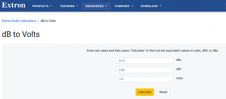

    Then you convert that maximum output voltage into dBV.
    how to stop windows 10 audio output volume resetting to 100% 399165d1697400371t-output-volume-3.png

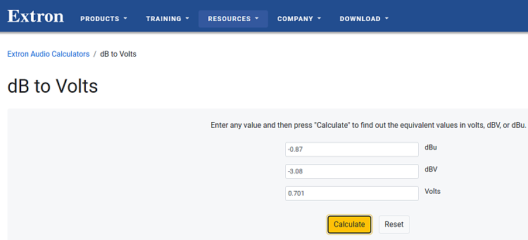

    So the Realtek ALC662 audio chip will have the 2.92 dBV as its maximum analog audio line-out output. Since the reference level is -10dBV, the audio chip has 12.92 dB of "headroom". Since the default Windows volume is -6 dB, the ALC662 will output at -3.08 dBV or 0.701 Volts. Since the reference level is -10 dBV, you are getting 6.92 dB above the reference level.
