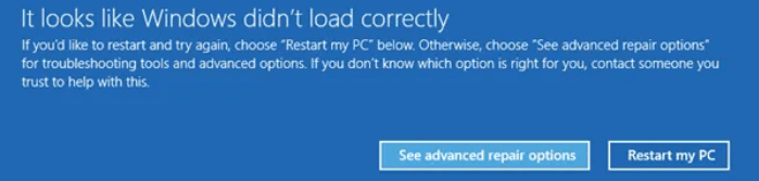

    When you clone SATA SSD to NVMe SSD there isn't required drivers on Windows and it will not boot, but it can be fixed by booting in safe mode. (I did this few days ago when upgrade old laptop with NMVe SSD.)
    When you boot first time with that new NVMe disk it fail and you have two options how to enter safe mode.
    Option 1) Let it fail until it attempt to automatic repair and when you see this screen select Advanced repair options to enter repair environment.
    How to transfer Windows from SATA HDD to NVMe M.2 SSD 2847bb53-0c03-4d03-9952-cf05c1a57862?upload=true.png
    Option 2) When OS start boot and you see those spinning dots push power button to force power off, on third boot it will open repair environment.
    When you are in repair environment follow these instructions to boot in safe mode.
    PCIe SSD not booting after cloning from SATA SSD/HDD | Crucial.com
    This will install correct NVMe driver and boot to screen asking user name and password. At that point do not enter anything, just use power button on lower right cornet on screen to restart. Now it should boot normal mode and you can sign-in.
    Pauli O, Mar 30, 2023
