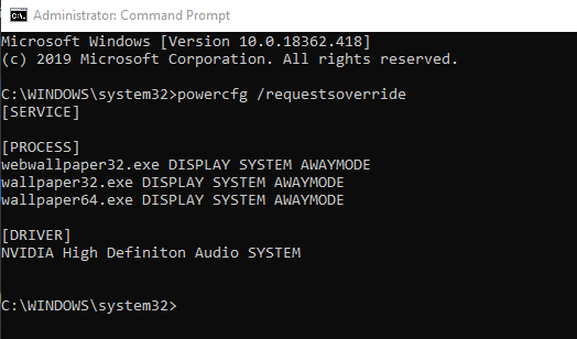

  2. How do I delete powercfg requests overrides?
    I recently used the "powercfg /requestsoverride" command in an attempt to fix an issue with my display not turning off. Turns out that this didn't help with the issue, and I am wondering if there is any way to delete these overrides or reset to defaults.
    How to undo powercfg -Requests Override? 15139896-37bd-4262-acf5-c4d135bd104f?upload=true.png
    Thomas Sfikas, Mar 22, 2021
  3. alphajoe Win User
    Windows 10 wont sleep automatically
    I know this is an old thread, but I figure someone may want an answer for this one. Just do the request override without the override type at the end.
    powercfg -requestsoverride DRIVER "srvnet"
    OR, look at the end of step 2 in freestyle's answer above Alejandro's question *Biggrin

  4. Saltgrass Win User
    powercfg -requestsoverride errors
    Did you run the command below to check your command. If the powercfg /requests shows the Realtek driver it use whatever it shows, as indicated by the listing after using the command.
    powercfg /requestsoverride /?
    Saltgrass, Mar 22, 2021
