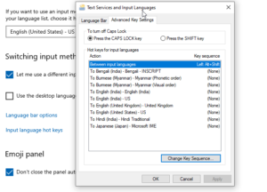

  4. How to use the Shift key to enable or disable Caps Lock in Windows 10
    Disable Caps Lock on Windows 10?
    The below does not disable CAPS LOCK; instead it converts CAPS LOCK into SHIFT LOCK.
    • Right-click Start
    • Choose Control Panel.
    • Under Clock, Language and Region, choose
      Change input methods.
    • On the left, choose
      Advanced Settings.
    • Near the bottom, click on
      Change language bar hot keys (this is a blue link)
    • On the Advanced Key Settings tab, select Press the Shift key
      radio button.
    • Click OK, then Save
    After this change:
    • You press the CAPS LOCK key puts the keyboard in all-caps mode
    • You press the SHIFT key to turn off CAPS LOCK and exit all-caps mode.
      • Note that pressing CAPS LOCK again
        will not turn off CAPS LOCK; only by pressing either SHIFT key will CAPS LOCK turn off.
    This is similar behavior to how the SHIFT LOCK key works on typewriters.
    blackeneth, Mar 15, 2020
