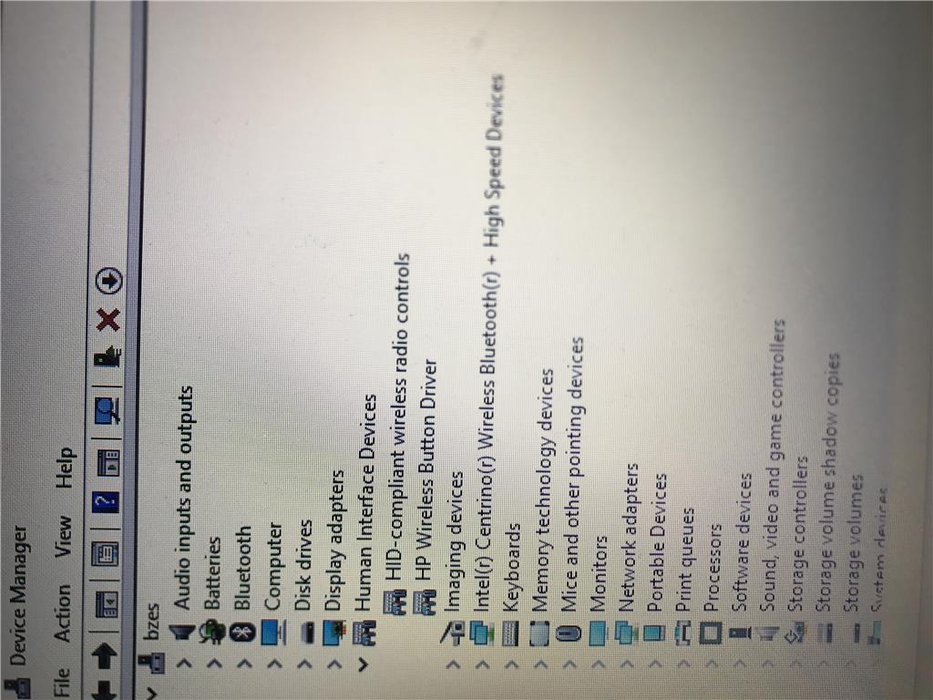

    Touch screen not working on my HP ENVY TS SLEEKBOOK 4
    Plz. Help!! I just realized suddenly that my touch screen is not working on my laptop( HP ENVY TS SLEEKBOOK 4) since 2 days. I tried restarting and online help and checking on my "device manager"-"human interface device" but there isn't any setting regarding
    the touch screen . All I can see there is "HID-complaint wireless radio control " and "HP Wireless button Driver" options.
