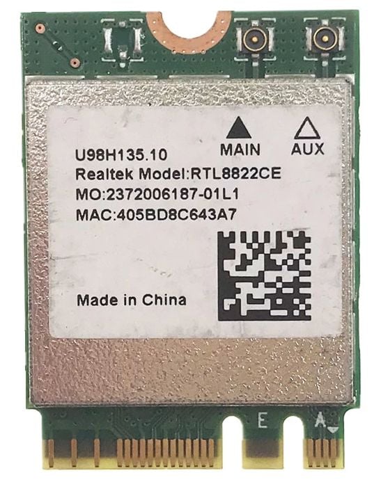

    Well that does sound like a wireless card issue. On most laptops this is a small physical card that can be removed, they look like this...
    HP Pavilion 15 Gaming - Help debug frequent BSOD almost everyday 381085d1670926334t-bsod-hp-15-pavilion-w10-home-22h2-v2-logfile-uploaded-realtek-rtl8822ce.jpg_.jpg
    If the laptop is still under any warranty then I would RMA it with a report of wireless card faulty. If it's not under warranty, and you feel comfortable opening it up, you can remove the Realtek wireless card and eliminate any possibility of a future problem from it.
