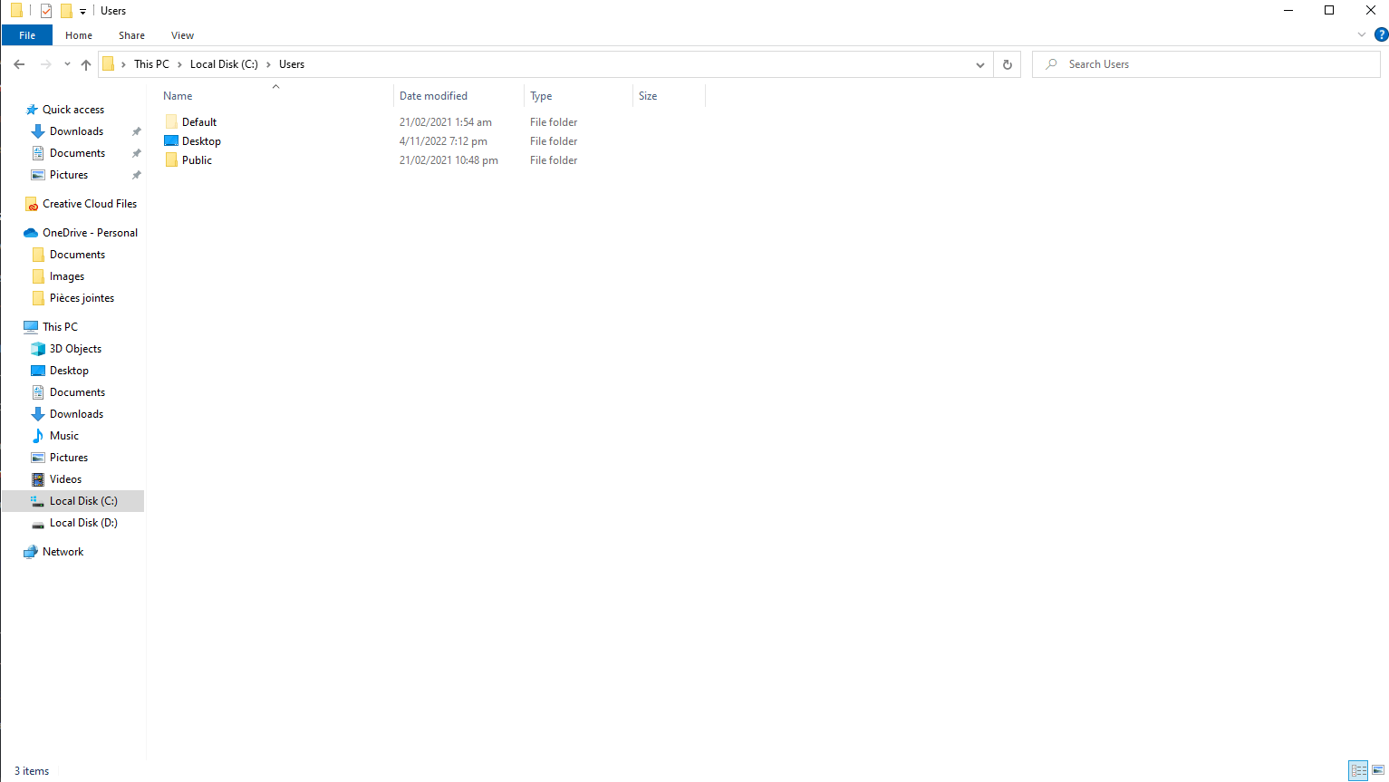

  3. Accidental merge of desktop folder with User folder
    hello, I was moving my user folder from my SSD to my HDD, I first started with the desktop folder but decided to move it back, I ended up merging my user and desktop file.
    I also restarted the computer after the error and all of the shortcuts on the desktop don't work anymore as well and show a planet icon
    I Have tried to follow the answer to this question, but it didn't work:
    Redirecting
    I accidentally merged Desktop folder and Documents folder b0d22047-d377-41ca-956b-b9900cae2135?upload=true.png
    Nadric Dumte, Jul 30, 2023
