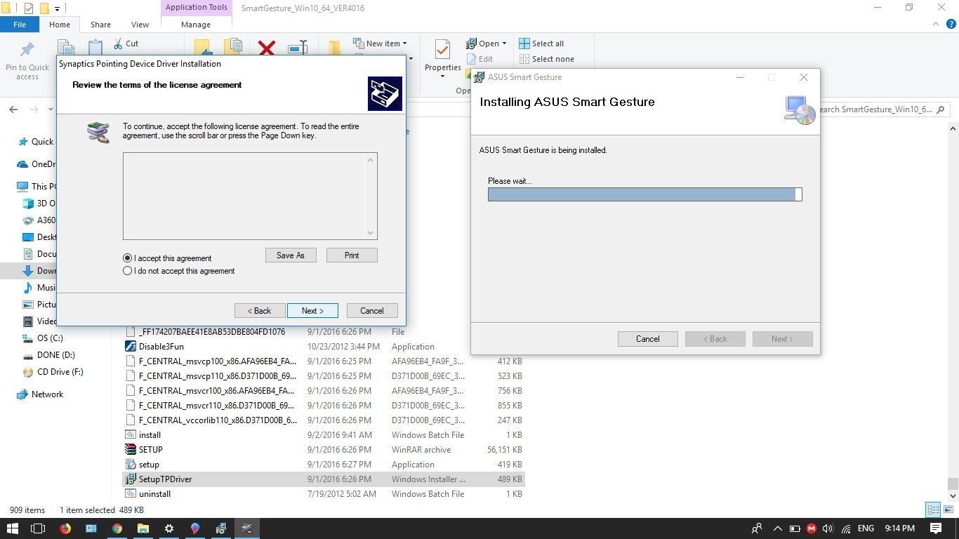

  1. I accidentally uninstalled ASUS smart gesture
    I uninstalled the smart gesture by accident
    After i downloaded it again and try to installed it
    Before finished, i had asked to install synaptic pointing device
    But it stopped at the agreement and i can't continued it
    Thank you for the answer !!
    I accidentally uninstalled ASUS smart gesture 1cc6f166-fb91-4e0a-b1c9-dd2214a4c81b?upload=true.jpg
    DoneHasibuan, Aug 10, 2018

  3. I accidentally uninstalled smart gesture.. ASUS
    Hi Sabrina,
    From the description above, I understood that you uninstalled smart gesture accidently, downloaded again and after two days it’s not working. So, as you have already
    downloaded
    the smart gesture driver, try to install in compatibility mode and check if it’s working.
    Follow the steps below on how to install driver in
    compatibility mode:
    • Download the driver from the manufacturer’s website and save it on your local disk.
    • Right click on the setup file of the driver and select
      “Properties”.
    • Select “Compatibility” Tab.
    • Place a check mark next to“Run this program in Compatibility mode” and select operating system from the drop down list.
    • Let the driver install and then check the
      functionality
    Hope it helps.
    Regards.
    SujataMoktan, Aug 10, 2018
  4. I accidentally uninstalled ASUS smart gesture
    Asus smart gesture
    I also had this problem after updating to win. 10 here are the steps that WORKED:
    1. control panel>uninstall prog.>asus smartgesture>REPAIR> restart
    2. control panel>uninstall prog.>asus smartgesture>uninstall>restart
    3. http://support.asus.com/Download.aspx?SLanguage=en&m=Smart+Gesture
    download the driver according to your win ver.
    4. restart.
    GuyBenShachar, Aug 10, 2018
