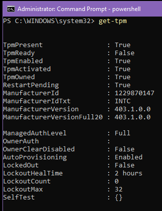

  4. I always get a random BSOD after "The TPM was successfully provisioned and is now ready for...
    Windows 10 21H2 "The TPM is not ready for use"
    I cannot get Windows 10 to actually use my PTT 2.0 (TPM equivalent). It continually reports "The TPM is not ready for use".
    2 year old Dell G315 Laptop with Intel PTT 2.0 ENABLED in BIOS.
    Intel Core i5-8300U CPU.
    UEFI Secure Boot is ENABLED. (Legacy ROM boot is DISABLED)
    Boot disk is a GPT-partitioned NVMe device.
    Device Manager shows Security Devices > Trusted Platform Module 2.0 > "This device is working properly."
    Settings > Windows Security > Device Security > Security Processor = Attestation: Not Supported, Storage: Not Ready
    Windows runs and boots fine.
    All Windows updates are installed.
    The Windows 11 update nag message reports the machine is capable of running 11.
    Have tried both a local admin user account and a Microsoft Account.
    Have tried the following steps NUMEROUS TIMES over and over...
    Used BIOS Clear PTT during boot up and Windows will not initialize or take ownership of the PTT.
    Used TPM.MSC Prepare and Clear and Reboot.
    Used Powershell Cmdlets to Clear and Take Ownership.
    System Event Viewer shows me "The TPM was successfully provisioned and is now ready for use". But when I look at the TPM.MSC is continues to display as STATUS: The TPM is not ready for use.
    And GET-TPM shows me:
    I always get a random BSOD after "The TPM was successfully provisioned and is now ready for... 6844766b-74bf-405a-8b0f-0b25c3517340?upload=true.png
    I've spent hours on the web researching and I'm out of ideas and options. Any help would be appreciated. I KNOW I'm going to be told to perform a fresh Windows installation but it's a complicated software dev laptop and I'm resisting all the time required to fix it back up after a fresh install. Thanks!
    Mike Tanis, May 26, 2024
