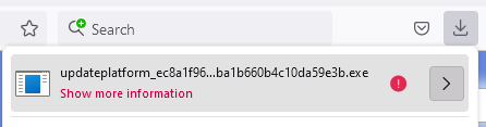

    There is nothing wrong with your system, it is behaving correctly. This is a well known issue. The reason for the 'potential security risk' is that the download link is to an http: url, not a secure https: server. Goodness knows why MS do it this way, but that's how Microsoft have been doing it for years. It's only recently that Firfox has started warning about such insecure downloads. It is in fact safe to download these Microsoft catalog links. To do that in Firefox, click the arrow at the right of the download warning...
    I am struggling to do updates as my update centre keeps saying security risk important... 363301d1648596462t-update-windows-defender-kb4052623-fails-labelled-security-risk-image.png

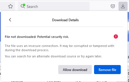

    ...to get this, where you can allow the download:
    I am struggling to do updates as my update centre keeps saying security risk important... 363302d1648596523t-update-windows-defender-kb4052623-fails-labelled-security-risk-image.png

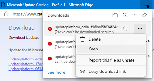

    And it doesn't help using Microsoft's own Edge, that too will not download until you jump through a few hoops.
    I am struggling to do updates as my update centre keeps saying security risk important... 363303d1648596869t-update-windows-defender-kb4052623-fails-labelled-security-risk-image.png
