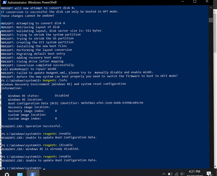

  3. cognus Win User
    Reagentc failed
    Shawn or other friend; in using MBR2GPT this am on a fresh install for which I used Win usb media - all of which went well, the conversion went well, but the edit to Reagentc failed. I thought, per the suggestion in the MBR2GPT.exe helps, to disable /enable but it all fails. Suggestion?
    paste:
    Code:
    I am trying to fix the REAGENTC.EXE: Unable to update Boot Configuration Data problem on my... 252973d1572470851t-reagentc-failed-screenshot1.png
    cognus, Sep 5, 2024
