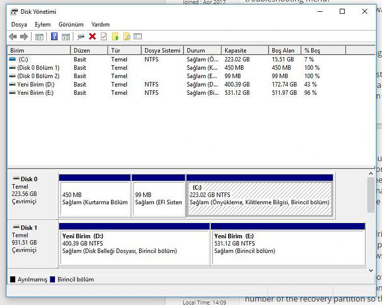

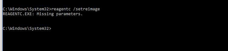

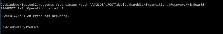

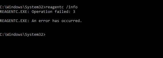

    windows 10 no advanced-startup-options, so no startup settings
    I can not find Startup Settings in Advanced options 152848d1505165150t-windows-10-no-advanced-startup-options-so-no-startup-settings-c.jpg
    I can not find Startup Settings in Advanced options 152849d1505165150t-windows-10-no-advanced-startup-options-so-no-startup-settings-c2.jpg
    I can not find Startup Settings in Advanced options 152850d1505165150t-windows-10-no-advanced-startup-options-so-no-startup-settings-c3.jpg
    I can not find Startup Settings in Advanced options 152851d1505165150t-windows-10-no-advanced-startup-options-so-no-startup-settings-c4.jpg
    feelulive, Dec 12, 2023
  3. feelulive Win User
    when i did 1. 2. 3. steps i checked and problem was SOLVED
    but after 4. 5. 6. 7. steps i checked and no advanced startup options again
