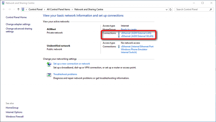

    When you create a Hyper-V virtual switch, that switch is from thereafter used also by your host to connect to the network.

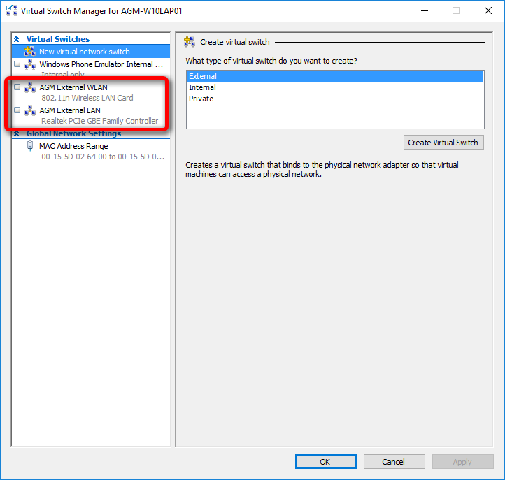

    Let me try to explain this. Here's how the virtual switch manager looks when both wireless and wired external switches have been created:

    When Hyper-V external virtual switches are correctly set up, the host will show this:
    I can not use Ivanti secure windows x64 due to error 1205 Failed To Setup Virtual Adapter... 33624d1485954993t-network-adapter-fails-connect-after-virtual-switch-setup-2015-08-24_22h34_30.png
    In the above screenshot you can see that my host computer is connected to the Internet with both a wireless virtual switch (WLAN) and wired switch (LAN). You can tell they are virtual switches from the vEthernet prefix. The host is no longer connecting using its physical adapters but uses insted the virtual switches.

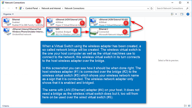

    Looking the adapters you can see this:
    I can not use Ivanti secure windows x64 due to error 1205 Failed To Setup Virtual Adapter... 33625d1485954993t-network-adapter-fails-connect-after-virtual-switch-setup-2015-08-24_22h50_22.png

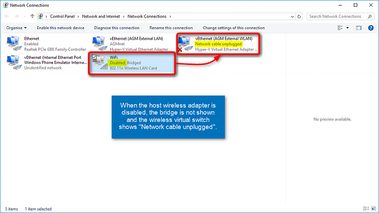

    If I now disable the wireless adapter, the bridge disappears and the wireless virtual switch shows Network cable unplugged:
    I can not use Ivanti secure windows x64 due to error 1205 Failed To Setup Virtual Adapter... 33627d1485954993t-network-adapter-fails-connect-after-virtual-switch-setup-2015-08-24_23h05_16.png
    To put this short: when you have set up an external virtual switch using a wireless adapter, from thereafter your wireless network adapter should never show Connected, nor should it never show a network name. It either shows Enabled, Bridged or Disabled, Bridged. That's how it should be.
    More about Hyper-V virtual switches at our sister site the Eight Forums: Hyper-V Virtual Switch Manager
