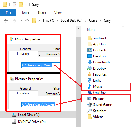

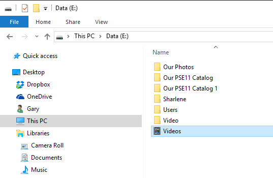

  3. Documents Location Changed But Property Location Is Correct - ???

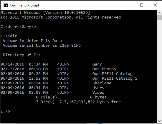

    I can't figure out why E:\Gary can't be seen in File Explorer.
    Sooooo .... let's try to get the special User folders back to normal
    These are ok per the location tab you posted
    Music C:\Users\Gary\Music
    Pictures C:\Users\Gary\Pictures
    I cant restore the Documents file to correct location 87575d1485968696t-documents-location-changed-but-property-location-correct-garyuser.png

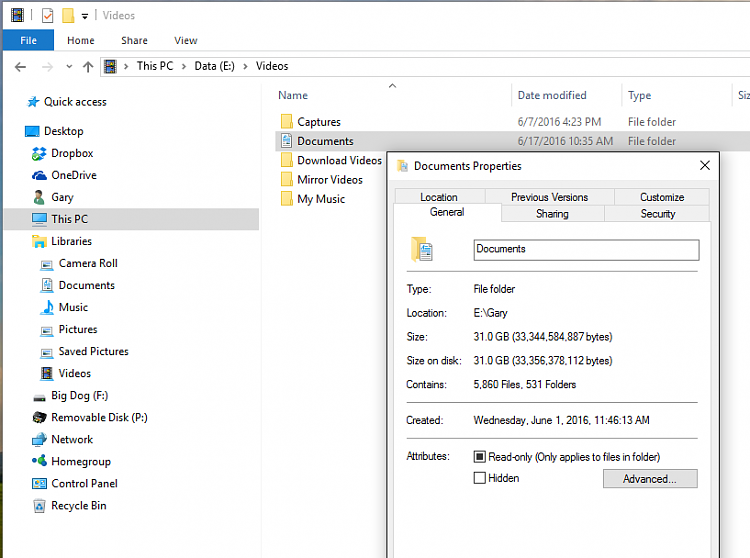

    Documents: E:\Videos\Documents location points to E:\Gary\Documents
    Videos: E:\Videos location points to E:\Videos (Could you confirm that with the properties> location tab)
    Try this in this order
    On E:\Videos\Documents
    Select properties > location tab
    Press the [ Restore Default ] button
    Yes to move files if prompted
    On E:\Videos
    That should put the two user folders back on C:\Users\Gary - please confirm the locations after restoring the default
    If everything looks good, then all that is left is to figure out why E:\Gary isn't visible in File Explorer
    Then put the folders where you want them. I might suggest a different structure if this becomes a sticky mess
    Something like E:\Usr\Gary\Userfolders - but see if the above resolves the issue.
    It's very possible that E:\Gary is really E:\Videos and is masked by the slight of hand Windows does with the special folders.
