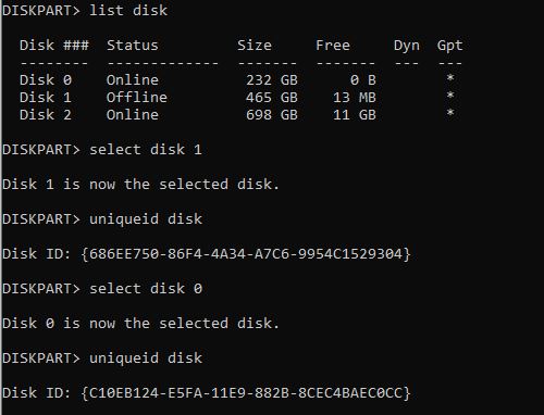

    I cloned my HDD to a samsung SSD using samsung magician.
    I then interchanged the SATA connectors of the two disks.
    System booted from the SSD with no problems.
    The HDD was not shown in file explorer and checking with Disk Manager I saw that it was offline because of signature collision.
    Using diskpart I changed the HDD ID. The picture below shows the IDs. Disk 0 is the SSD and Disk 1 the HDD.
    But still geting a collision. I still haven't right ckicked the offline icon in disk management to online *Smile.
    What am I missing here? Disks with different IDs shouldn't collide.
