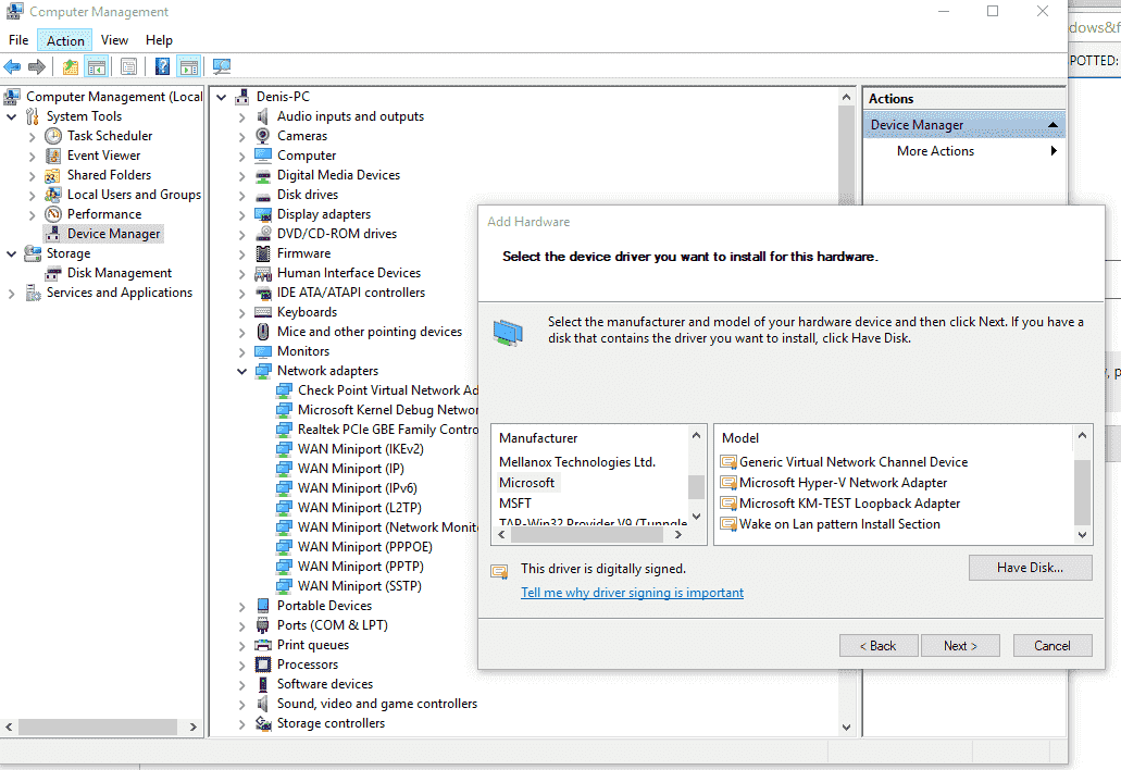

Discus and support I don't have teredo at all, any help please? in Windows 10 Drivers and Hardware to solve the problem; [ATTACH] I don't have teredo at all, any help please? I tried every single way to fix and nothing works... Discussion in 'Windows 10 Drivers and Hardware' started by denischertok1, Jul 20, 2018.
  1. I don't have teredo at all, any help please?
    I don't have teredo at all, any help please? da6f41c6-d074-4bdf-89bb-e7bc7ae8065c?upload=true.png

  3. Can You Please fix the teredo adapter problem already?
    Hi Mr Overshield,
    Teredo being disabled is one of the possible reasons why you're unable to fix the Teredo problem as well as can't find it under hidden devices. To re-enable your Teredo on your device, I suggest that you follow the steps below:
    • Type in cmd in to the search bar on your desktop and right click on Command Prompt and run it as admin.
    • Type in netsh interface Teredo set state type=default
    • Kindly restart your computer to let the changes take effect.
    Note: No need to reinstall the Teredo as it will install itself.
    For additional information and troubleshooting steps, you may visit the link below:
    Click here
    Kindly update us with the results, so that we can assist you further.
    Wilfred Mac, Jul 20, 2018
  4. Jelu Cal Win User
    Teredo Tunneling not on computer.
    Your concern about Teredo Tunneling can be due to the configuration of the device. We'd recommend performing the following commands to fix your concern:
    • Search Command Prompt using Cortana.
    • Right-click on Command Prompt.
    • Select Run as administrator.
    • Type the following in order:
      • netsh, press Enter.
      • int ipv6, press Enter.
      • set teredo client, press Enter.
      • Check if the item is already posted.
      Note: If the above steps did not suffice, proceed to the next step.
    • Search and launch Device Manager using Cortana.
    • Search and locate LogMeIn (Hamichi) if it's listed. If yes, proceed to the next step.
    • Right-click on the specified driver, and then select Properties.
    • Click on the Driver tab.
    • Locate and click on the Disable button.
    • Check if Teredo Tunneling is already posted.
    In the event that the above steps didn't work, we'd recommend posting the query in our TechNet forums. The community consists of IT Professionals that would be able to impart their knowledge in relation to your concern. To reach the site, click on this
    link
    Note: We'd also recommend to check this thread from time to time as there might be a community member either existing or new that may be able to share their expertise with Teredo Tunneling.
    Let us know should you need further assistance.
    Jelu Cal, Jul 20, 2018
