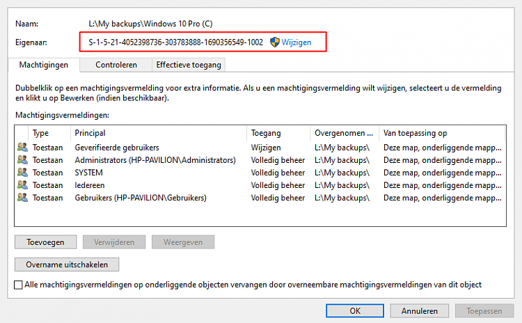

    Hi guys, I have a peculiar issue with an unknown Owner of a folder.
    To be more precise, its on my external Drive, in a folder called My Backups.
    I use Acronis on a disk to perform backups. Acronis is not installed.
    Path: ‪L:\My backups\Windows 10 Pro (C)
    Owner: S-1-5-21-4052398736-303783888-1690356549-1002

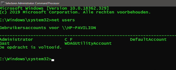

    I entered "net users" in cmd.exe & the above account is not listed there.
    I have a built-in Administrator-, Guest-, Default-, WDAGUtility- and my current account.

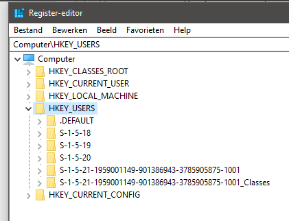

    The above Owner number does not appear in Regedit either.

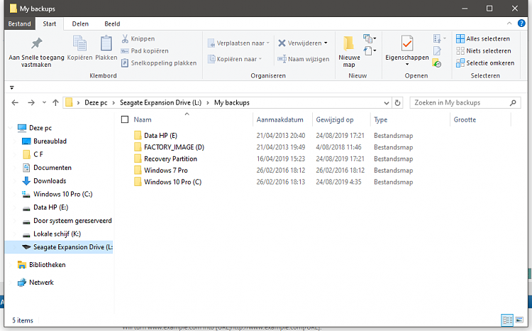

    Ok, slight change of plans. I was going to post the above when I did a closer inspection of other folders & files in L:\My backups. ‪L:\My backups\Recovery Partition has yet another unfamiliar Owner!
    I had only 1 user, so I decided to turn it from Administrator to Device Owner, but now... 245894d1567715898t-unknown-user-owner-explorer.png
    Owners of the 5 backup folders:
    ‪L:\My backups\Data HP (E): Administrators (HP-PAVILION\Administrators)
    ‪L:\My backups\FACTORY_IMAGE (D): Administrators (HP-PAVILION\Administrators)
    ‪L:\My backups\Recovery Partition: S-1-5-21-2524673758-597247510-780583039-1001
    ‪L:\My backups\Windows 7 Pro: S-1-5-21-4052398736-303783888-1690356549-1002
    L:\My backups\Windows 10 Pro (C): S-1-5-21-4052398736-303783888-1690356549-1002
    So I have to ask again, who could this be, and is it safe to set them all as a member of Administrators?
