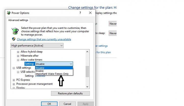

  3. Hoggorm Win User
    Windows won't activate screensaver, or sleep, with game controllers in
    I just tried this and unfortunately the list is the same indicating the game controllers do show up in the list at all. They are currently connected to a TP-Link UH720 USB 3.0 7-Ports Hub.
    I tried this as well now and unfortunately the screensaver does not start after the set time when I changed the setting from Enable to Important Wake Timers Only.
    Hoggorm, Apr 7, 2024
