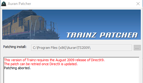

  2. Issue with DirectX August 2009
    I've upgraded from Windows 8.1 to Windows 10. Due to software issues I'm concidering formatting my harddrive and re-installing Windows 8.1 if I can't work this out!
    I installed a train simulator and it needs a patch file to update it. I tried the update but apparently, DirectX August 2009 was missing, so I downloaded it from: www.microsoft.com/en-au/download/details.aspx?id=6883.
    Issue is this. When I tried to install it, it advised me that the area in which I was trying to install it was invalid. So following advice from different forums including that of Microsoft, I opened a temp folder and put it there. Tried the patch again
    and got the same error message DirectX August 2009 is missing.

  3. BossDweeb Win User
    Trainz 2009, yes ? Not obsolete.
    If the game is a download from Steam or similar site there should be no need to install a patch as is will have
    been pre-patched by Steam.
    - Note the Trainz '09 Service Packs page suggest you clear out the Temp folder before trying to install the Service Pack
    N3V Games Shop: Simulator Games, Casual Games and Gamer Games
    If you have not done so, run the DirectX Web Installer to verify all DX files are installed.
    Download DirectX End-User Runtime Web Installer from Official Microsoft Download Center
    - The DX redist installer you linked to is outdated.
    In the event your Win10 has all DX files and there is a corrupt file or files use the DX Redist (June 2010).
    This installer is cumulative and includes the most recent DX9,10 and 11 files (Recent ? ).
    Download Details - Microsoft Download Center - DirectX Redist (June 2010)
    Note that you first unpack the files to a folder of your choice. The desktop is a good place for this
    as this folder can be deleted once the reinstall of DX if finished.
    Step 2 - Use theDXSETUP.exe that you will find in this folder to finalise the DX reinstall.
    As you seem to have previously unpacked the DX installer into your Temp Folder, you should clear the
    Temp folder as well. You can do this by running Windows Disk Cleanup,
    or by manually deleting the files.
    - Some games install a copy of the DX file/s they use in the games main install folder. In this case if the file in question is
    corrupt you can copy the file with the same name, eg- d3dx9_39.dll, from
    System32
    to the games main folder
    (or sub-folder with the games .exe launcher ).
    - Many games also install a sub-folder with a name such as Redist . This folder may have a DX installer in it as well
    as Visual C++ (vcredistx86) that you could use to reinstall these features again.
    - It probably does not apply to this game, but in the past some games had permissions issues if you installed to
    the default location - Program Files(x86). Try installing to a new folder in another partition or HDD.
    If you have only a C:\ drive/partition make a new folder there and try installing the game in that folder.
    - For fixes to peculiarities with the game you would do better to post on a dedicated Trainz forum such as....
    https://www.trainzportal.com/
    BossDweeb, Apr 12, 2020
