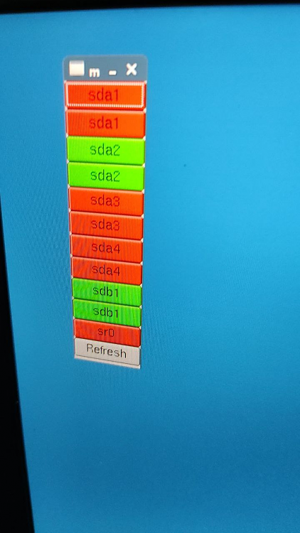

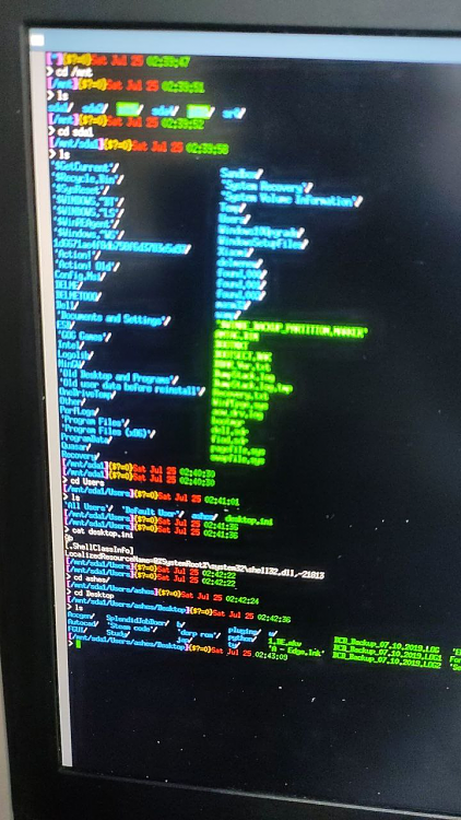

    Hey! thanks for the response!, i tried running Sea Tools and i have interesting results,
    SMART Test - PASS
    But the most interesting part is that, i have a "mount" program in Sea tools, so when i mount sda2, sda3,sda4
    then when i go to /mnt/sda2, /mnt/sda3 and /mnt/sda4, i can see all of my data there!! all the files, all the folders, just as they were..
    I can even read the contents of text files (using cat command).. so it seems my data + paritions are there but then why am i facing this terrible issue ? *Sad(

    Mount tool:
    I lost data from my HDD after temperorily connecting my backup HDD 289437d1595625297t-lost-partitions-hdd-hdd-regenerator-image.png
    So DISKPART can show all my partitions and volumes properly
    and in Seatools , i can mount all partitions and List and read all my files and folders without any issues..
    so what should be my next step :/ i don't wanna mess this up
