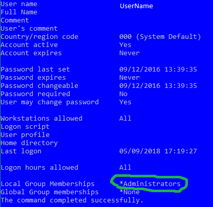

    Tony,
    If the response to the command net user UserName [for the UserName of the new Admin account] contains
    the Local group memberships entry Administrators, and
    the Account active entry Yes,
    I lost my admin status on my account because of hamachi and I can't get it back 202525d1536164873t-lost-admin-user-status-win-10-home-net-user-username.png

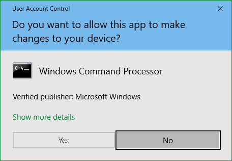

    and you can log in to the Admin account correctly [i.e. without getting an error, "The User Profile Service failed the logon."]
    but you are still not getting a Yes button in Admin challenges ["ElevationUI", "ConsentUI"]
    I lost my admin status on my account because of hamachi and I can't get it back 202526d1536165198t-lost-admin-user-status-win-10-home-admin-consentui-yes-greyed-out.png
    then that Admin user account must be faulty. If the same thing happens when you create another new Admin account then I cannot think of any solution other than reinstalling Windows 10.

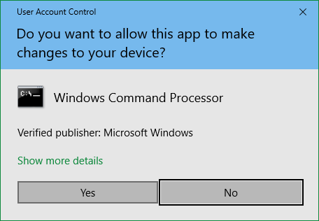

    - That's why you will see that Admin challenge when doing certain jobs -
    I lost my admin status on my account because of hamachi and I can't get it back 229381d1554212379t-windows-10-permissions-issues-admin-consentui.png
    In case this is confusing, I can put it another way.
    - When you log in using your Admin account, you are only a potential Admin.
    - You are not an Admin until you deliberately invoke your Admin status and that Admin status lasts only for the job that you have invoked it for.
    All this is why following Bree's advice about giving a named account access to that folder was the correct thing to do for your 'potential Admin' account to be able to write to that folder.
    - Before this change, your Administrators only had access after they had invoked their status.
    If I have merely confused you further then please say so.
    Denis
