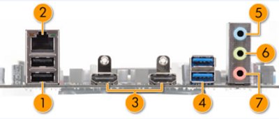

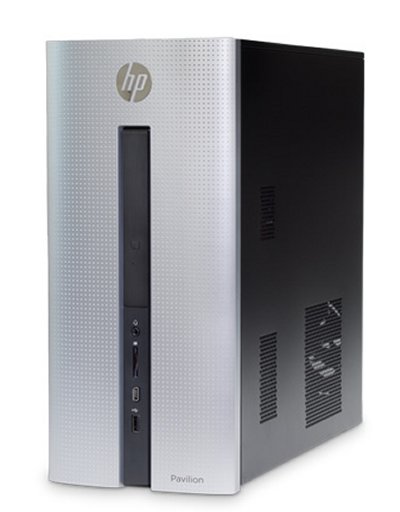

  3. mnsdfhrug Win User
    HP Pavilion desktops headphone and microphone input
    I NEED HELP I HAVE A AUDIO HEADSET MEANING THAT I HAVE A MICROPHONE ON A HEADPHONE BUT IT... c05258839.jpg
    I NEED HELP I HAVE A AUDIO HEADSET MEANING THAT I HAVE A MICROPHONE ON A HEADPHONE BUT IT... c05240717.jpg
    1. USB 2.0: 2
    2. LAN (Ethernet)
    3. HDMI out
    4. USB 3.0: 2
    5. Audio: Line in
    6. Audio: Line out
    7. Audio: Microphone
    Here are photos of the front and back of one of the HP pavilion desktops. As seen on the front, you can only plug in headphones, but not microphone so I can't use that. Looking at the back, I'm not sure what audio line in and line out means. Microphone can probably work with slot 7 but I'm not sure about the headphones.
    I need the headphone and microphone ports to be very close to each other, so I can plug in a typical headset.
