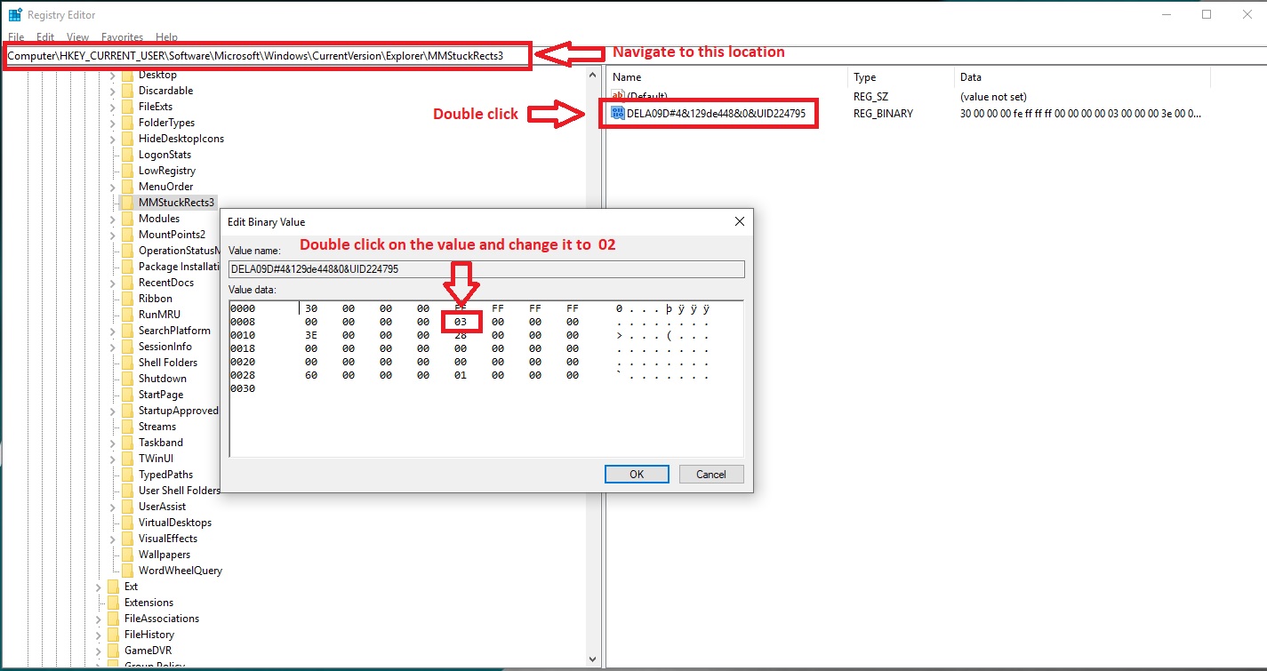

    We understand your concern as you are unable to set the taskbar location on your PC. We appreciate your effort in providing us the detailed information about the issue.
    We researched and reproduced the issue on our lab machine. As we can see that you have two queries, let me address the first issue that is location changes from "right" to "custom".
    This is by design, whenever you have multiple monitor connected to the PC and you have set the taskbar location to default (i.e. bottom) you will see 5 option and the 5th option is
    Custom. Now if you change the taskbar to right of the screen for all the display. The Windows settings will show you 4 option because you have already customized to Right.
    Now, let us move to the second issue and that is the taskbar location changes on the secondary displays to default (i.e. bottom) after the restart. To prevent this problem we would suggest you to perform the registry fix as mentioned
    in these steps.
    1. Press Windows + R key to launch the Run command.
    2. Type regedit and click on Ok.
    3. Navigate to this location: HKEY_CURRENT_USER\SOFTWARE\Microsoft\Windows\CurrentVersion\Explorer\MMStuckRects3
    4. Now from right pane double click on binary value for all the display monitor listed one by one.
    5. Double click on the 03 value as shown in the screenshot and change it to
      02 for setting the taskbar location to the right. Just for your information
      00 is for left, 01 is for top and 03 is default i.e. bottom.
    6. Close the registry, restart the PC and check.
    Note: Important this section, method, or task contains steps that tell you how to modify the registry. However, serious problems might occur if you modify the registry incorrectly.
    Therefore, make sure that you follow these steps carefully. For added protection, back up the registry before you modify it. Then, you can restore the registry if a problem occurs.
    Follow the steps to take
    backup of registry
    I need the Location path to my Windows settings for a Custom taskbar 04c429e6-3c73-4e94-9549-ca70c50fb653?upload=true.jpg
