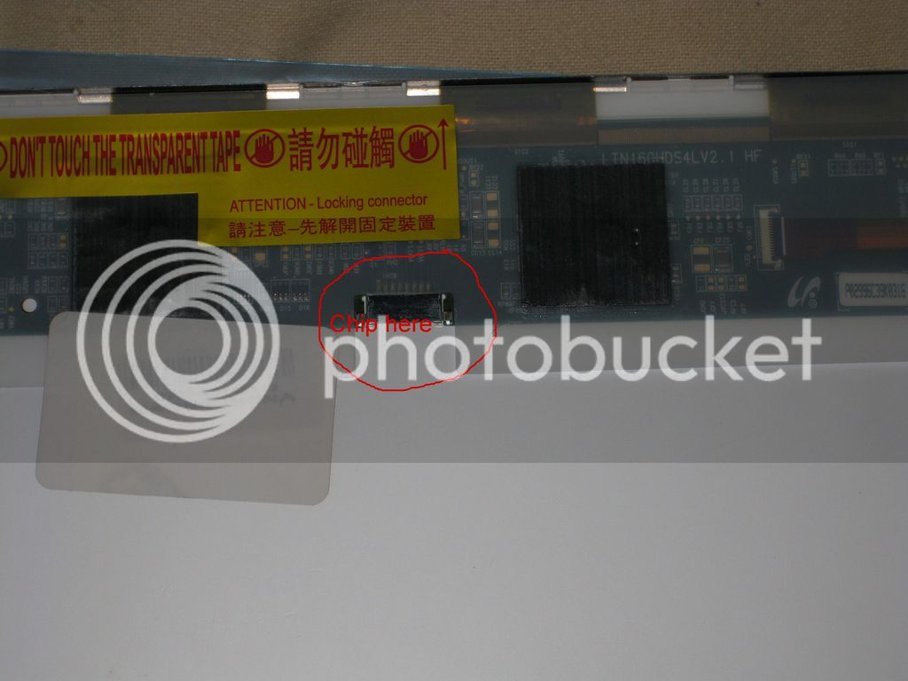

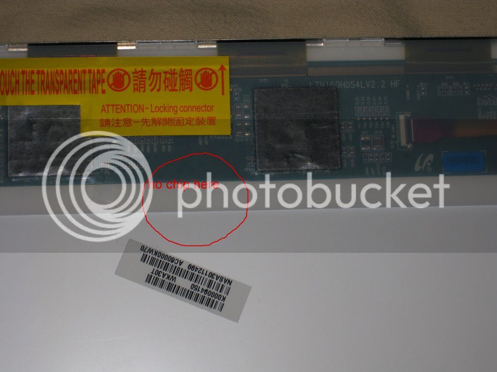

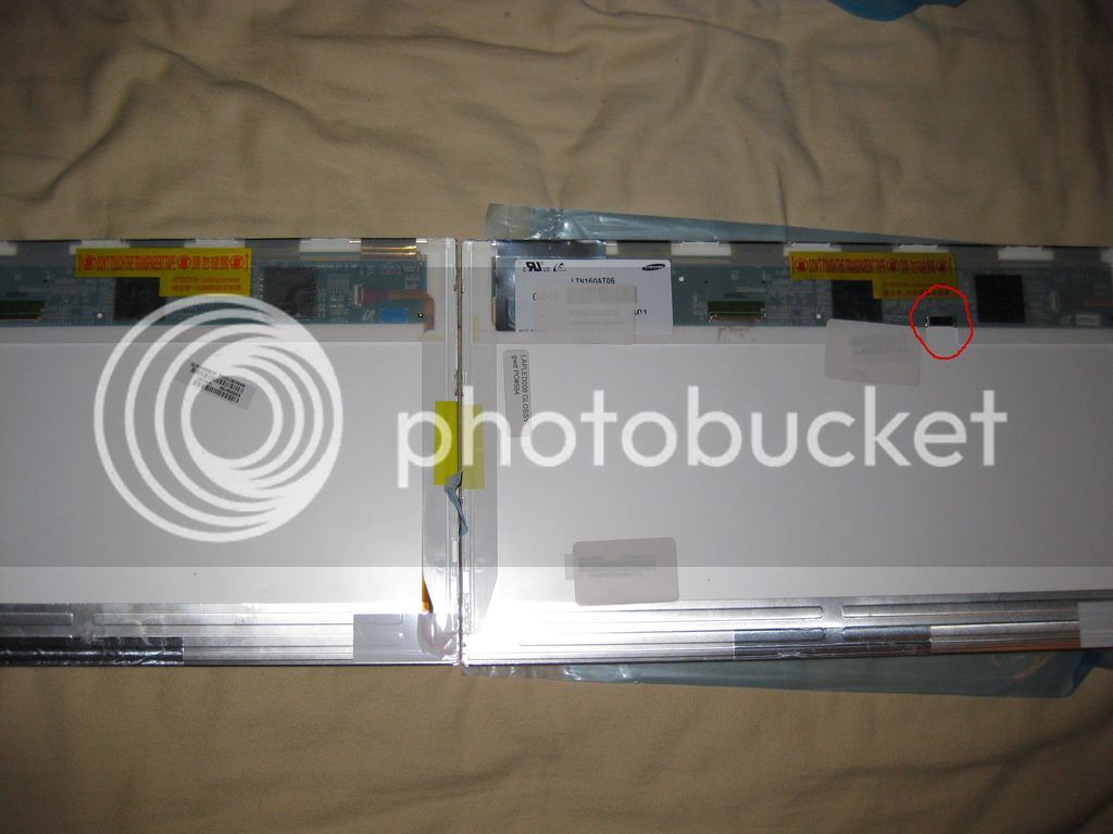

  3. Laptop replacement screen issue
    Hi. My friend dropped his laptop and cracked the screen so I ordered him a replacement screen. I've replaced many laptop screens without a single issue until now. I'm starting to think I possibly received the wrong replacement screen for his laptop and wanted to check with you guys and get some input. The video screen cable (part number DC020012110) doesn't want to lock into the video connector on the replacement screen like it does on the broken screen. Then I looked and I noticed a difference with the broken screen and the replacement screen I ordered. The broken one is absent a chip (not sure what to call it) that the replacement screen has. I took some pictures which you can see below showing the difference between these two screens. Is this the issue why I get light, but no picture with the replacement screen and why the cable doesn't like to fit the video connector as easy as it did on the broken screen? The video cable hooks up to the broken screens video connector with no issues and I get a picture except of course the screen is so cracked it's unusable. When I try to hook up this replacement screen I get white light and that's it. Like I said I'm thinking I was sent a wrong screen perhaps? Below are the pictures and hopefully by looking at them you can see the difference between them and understand what I'm saying. I have also included information on the make and model of the laptop and also information I got from the back of the broken screen. I want to note that the broken screen says "LTN160AT06-U01" and the replacement just says "LTN160AT06" despite this description listing it as U01...
    http://tinyurl.com/q7zgclt
    Help is greatly appreciated! Thank you!!!
    Toshiba Satellite A665-S6050
    Samsung screen data...
    Samsung 1024; LTN160AT06-U01; 6VAE20604Q; USP6639598/USP5280371
    LJ96-04832B; LTN160AT06-HO1; D206 18LSYHG1M 1B84
    K000094150 WKA30T
    NASA30112499 AC60000KW70
    I recently got my laptop screen replaced after I cracked it. The touch screen works... IMG_3196x.jpg
    I recently got my laptop screen replaced after I cracked it. The touch screen works... IMG_3195x.jpg
    I recently got my laptop screen replaced after I cracked it. The touch screen works... IMG_3194x.jpg
