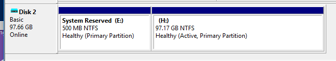

    I will do steps for a vhd
    Step 1 - make a copy of vhd (for real disk - an image backup) in case things go pearshaped.
    Step 2 - attach vhd using disk management - here disk 2 is legacy bios
    I saw these two on my task manager called "Camusage" and "Micusage" and saw in the history... 129328d1491845025t-tips-tricks-you-saw-first-tenforums-2017_04_10_17_23_481.png
    Step 3: shrink the OS drive (H here) to give room to write EFI partition. I actually shrank it a lot as I had no idea how much space it needed

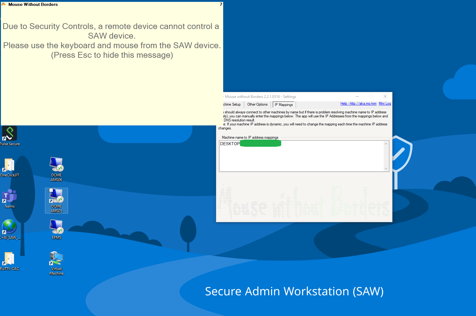

    SAW is not recognized as a SAW, how can I set my SAW as a SAW, this screenshot is taken on my SAW and speaks for it self, this message should not appear!!
    This screenshot is taken on my SAW and speaks for it self, this message should not appear!!
    When I want to control my remote device from my SAW I will get this message: !!!!!
    How can I set my SAW to a SAW so that Mouse Without borders recognizes my SAW as a SAW?
