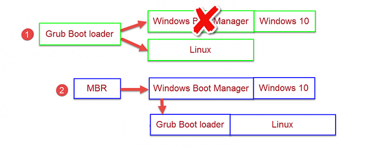

    One advice to you before installing LINUX. Don't let GRUB loader to take over the MBR and control the booting process, but install GRUB on its own partition. Normally, when installing LINUX, it will install GRUB on the MBR of the disk and be the default boot manager. take a look at the screen shot:
    I tried booting up Linux off of a pre-set up thumb drive and now my PC is getting the... 322954d1615894051t-how-can-i-move-windows-10-boot-files-another-drive-allow-linux-linux2.png
    By default, #1 will be installed and once done, you'll get an ugly dual boot screen from GRUB. #2 is the prefered way.
    1. Keep Windows boot manager in control.
    2. Since GRUB boot loader is in its own partition, you can boot it as a stand alone. You can
      also make an image or clone to another HD partition on another PC and it will work.
      What I did is to install and setup LINUX in one PC, make a copy and restore to another PC
      so all will be up to date.
    3. Windows won't know LINUX existed until you setup dual boot and you'll get the nice looking
      windows GUI dual boot menu using Easy BCD. If you later want to remove the dual boot, remove the
      entry with Easy BCD.
    4. Any update from Windows won't affect LINUX and vice versa.

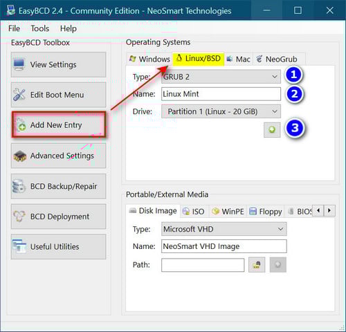

    4. Download and install Easy BCD then run -> Add new entry -> select GRUB2->Select the installed Linux partition.

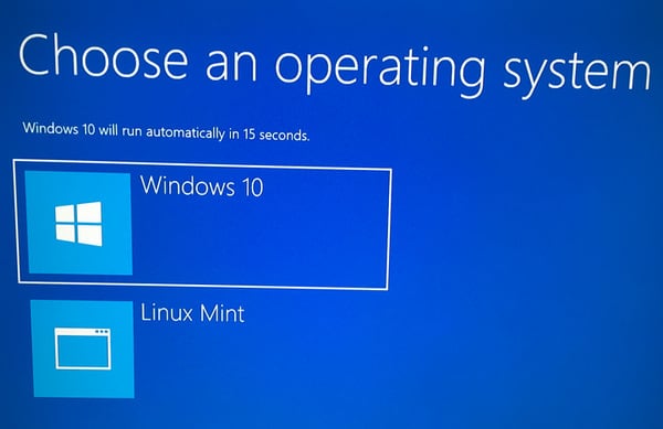

    5. Reboot, you'll will get the nice looking dual boot menu.
