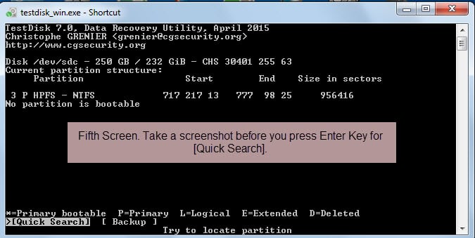

    Fifth Screen: Please take a screenshot. [Quick Search] Enter

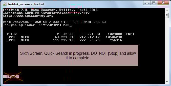

    Sixth Screen: Search in progress. Take a screenshot. Allow Quick Search to complete.( On my machine it took 45 minutes) Do not stop. If you stop no harm but you have to start all over again *Smile

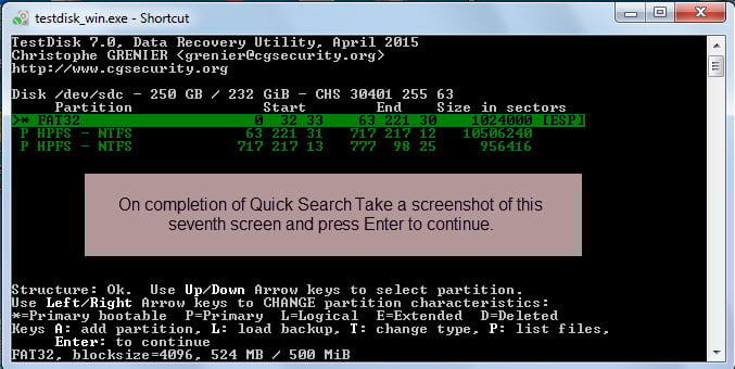

    Seventh Screen: On completion of Quick Search take a screenshot and press Enter to continue

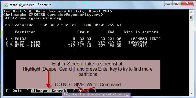

    Eighth Screen: Take a screenshot. Highlight [Deeper Search] to find more partitions - we are not sure that the found partitions are the only partitions on the disk, neither me nor you *Smile ( but I am sure that there should have been more in your case) -

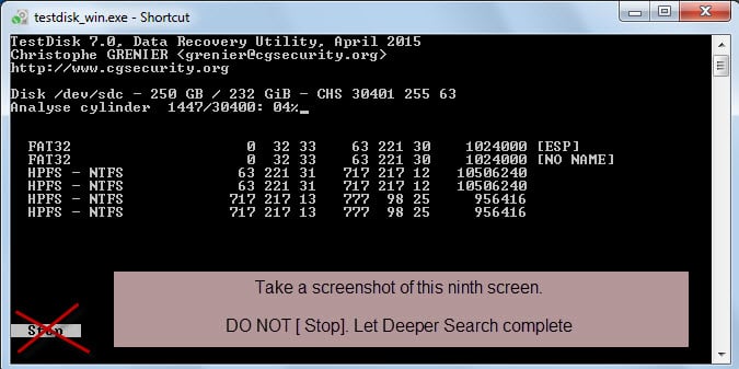

    Ninth Screen: Take a screenshot . Deeper search in progress. Allow it to complete.( On my machine it took one hour) Do not stop. If you stop no harm but you have to start all over again *Smile

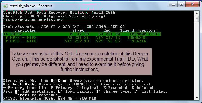

    Tenth Screen:Take a screenshot
