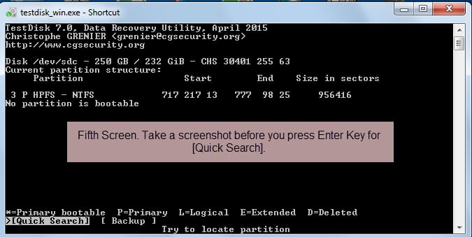

    Fifth Screen: Please take a screenshot. [Quick Search] Enter
    Idk what to do 232974d1557216241t-idk-what-im-doing-test-disk-256gb-400mb-07-may-19-10-04-00-am.jpg

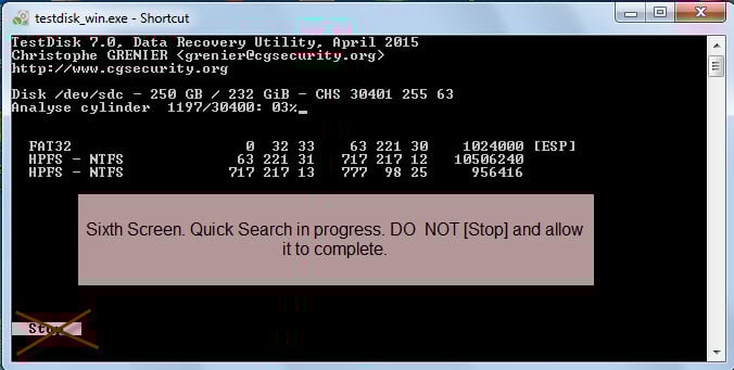

    Sixth Screen: Search in progress. Take a screenshot. Allow Quick Search to complete.( On my machine it took 45 minutes) Do not stop. If you stop no harm but you have to start all over again *Smile
    Idk what to do 232975d1557216479t-idk-what-im-doing-test-disk-256gb-400mb-07-may-19-10-09-30-am.jpg

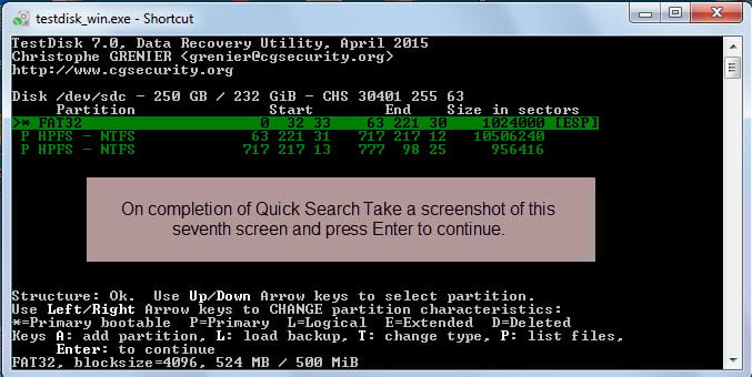

    Seventh Screen: On completion of Quick Search take a screenshot and press Enter to continue
    Idk what to do 232976d1557216603t-idk-what-im-doing-test-disk-256gb-400mb-07-may-19-10-56-26-am.jpg

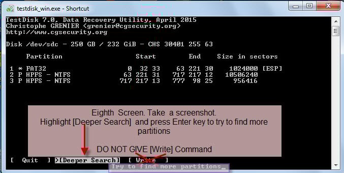

    Eighth Screen: Take a screenshot. Highlight [Deeper Search] to find more partitions - we are not sure that the found partitions are the only partitions on the disk, neither me nor you *Smile ( but I am sure that there should have been more in your case) -
    Idk what to do 232977d1557216982t-idk-what-im-doing-test-disk-256gb-400mb-07-may-19-11-12-55-am.jpg

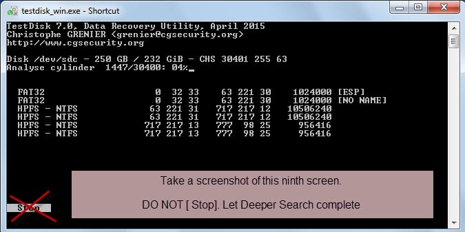

    Ninth Screen: Take a screenshot . Deeper search in progress. Allow it to complete.( On my machine it took one hour) Do not stop. If you stop no harm but you have to start all over again *Smile
    Idk what to do 232978d1557217516t-idk-what-im-doing-test-disk-256gb-400mb-07-may-19-11-26-11-am.jpg

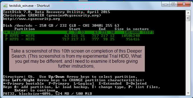

    Tenth Screen:Take a screenshot
    Idk what to do 232979d1557217984t-idk-what-im-doing-test-disk-256gb-400mb-07-may-19-12-24-57-pm.jpg
