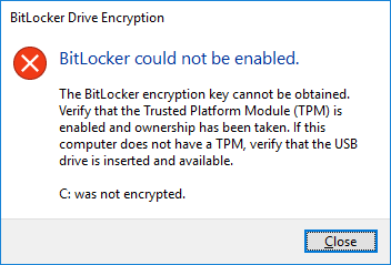

    When I started it again next day I saw following error during Windows start-up:
    impossible to reach the windows 11 recovery environment due to the error... kAXMF.png
    Now, I can see it with every Windows 10 restart. This is really weird for me, because -- as I wrote above -- BitLocker configuration was not finished and thus neither BitLocker is enabled nor encryption key is put to TPM.

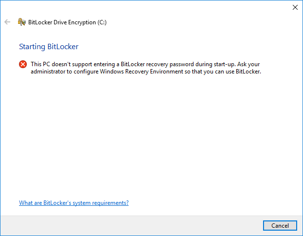

    Each time I try to re-enable BitLocker for C: drive I see following error:
    impossible to reach the windows 11 recovery environment due to the error... P1VMd.png
    I don't understand, how it is possible that Windows managed to move Windows Recovery Environment from C: drive to a hidden partition, but isn't able to move it back?
    Anyway, can anyone shed some light and explain me, what should I do now or how to proceed from this point? How to move back Windows Recovery Environment manually? How to get rid of that startup error message? And the most important -- how to enable BitLocker and encrypt my system drive on my tablet?
