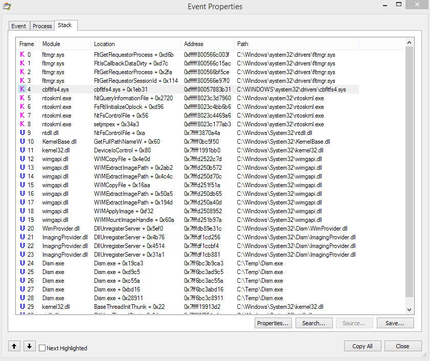

    Using Sysinternal's Process Monitor I could record dism.exe's actions and compare them to the desired ones. I noticed that the failed action (SetFileSize) occured once in the working mounting case, and twice in the failing one. I looked at the stacktrace of the failing action and saw that there was one additional call, in filter driver cbftlsfs4.sys.
    Some googling revealed that this file belongs to Cloudfogger. Uninstalling Cloudfogger (I moved to viivo some time ago after having different issues with Cloudfogger, so uninstalling was no issue) removed both the filter driver as well as the mounting problem.
