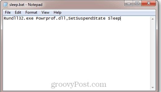

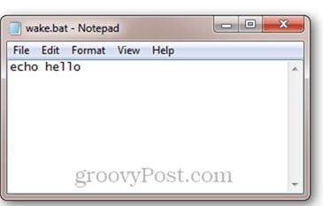

    Cannot Get Task Scheduler to wake or sleep (Win 11)
    I've meticulously set up Task scheduler to wake and sleep my Desktop. I use the following scripts:
    In Windows 11 I'm trying to open a task using Windows 11 Task Scheduler to wake the... 384356d1674752424t-cannot-get-task-scheduler-wake-sleep-win-11-a-wake.bat.jpg
    In Windows 11 I'm trying to open a task using Windows 11 Task Scheduler to wake the... 384357d1674752424t-cannot-get-task-scheduler-wake-sleep-win-11-a-bat-file-sleep.jpg
    But they are not working. Any help appreciated!
    Twangbang007, Jun 8, 2024
