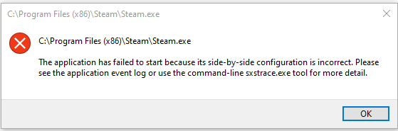

    TL;DR I have a side-by-side configuration issue for all my programs that I can't seem to solve.
    Incorrect side-by-side configuration Possibly a symptom of a deeper underlying problem 76952f26-1298-4237-804d-204a12c7a3de?upload=true.png
    Hi all,
    I'm not too sure what the root cause is but allow me to explain what happened.
    Today I have encountered a problem where I am unable to access any of my programs on my computer, with the error screen capped above. I looked online to try and solve my problems but to no avail. Below are the fixes I have tried along with the results of my attempt
    - Ran SFC Scan and Restore Health No errors arose
    - Attempted to uninstall Microsoft Visual C++ Received an Error 1719, Windows Installer Service could not be accessed
    - Attempted to run a Systems Restore Restore had failed.
    - Downloaded the Media Creation Tool for a full reset Can't access tool as it has the side by side error as well
    I did a deeper dive into the matter and I looked up the error in Event Viewer for SideBySide and these were the details I got. This is a recurring issue with the other errors as well.
    Incorrect side-by-side configuration Possibly a symptom of a deeper underlying problem deeab87e-3eb1-43c6-8761-d7fa3af4e725?upload=true.png
    So then I assumed all I would need to do is to download Microsoft Visual Basic 6.0 Common Controls from https://www.microsoft.com/en-us/download/details.aspx?id=10019 and problem solved, but when I attempted to download it, again I have the side-by-side configuration error.
    It just seems that I am running around in circles looking for a solution, any help would be greatly appreciated.
    Thanks in advance.
