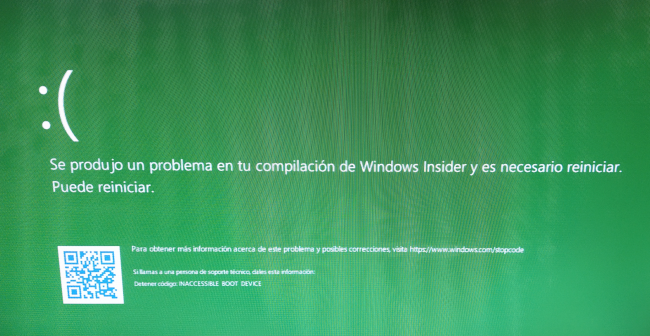

    From some days ago, Windows 10 doesn't start. It only shows a green screen with the message "Inaccessible boot device".
    Innaccesible boot device: ran out of space ce21d5de-09e9-4726-85fc-ebf04327b6dc?upload=true.png
    I don't know why. However, the user that works with this computer, says it was warning about run out of space. I've checked that only left less than 2 GB empty, so I think it is related with the problem.
    I have some computer skills, but mostly about programming, not about system repair. I'm trying with "Repair System" option but doesn't work. I've done CHKDSK with F option, and it repair something, but the problem persist. I'm trying with Fixmbr and Fixboot, although I thought it wasn't the problem, and it didn't solve anything. The OS neither start in fail-safe mode.
    I need help to if someone knows which is the problem, or any possible solution.
    What logs file should I watch? On ntbtlog.txt, last message is "Did not load driver AFD.SYS". Could it be related?
    Tomorrow I'll try with this link about dism and sfc https://support.microsoft.com/en-us/windows/using-system-file-checker-in-windows-10-365e0031-36b1-6031-f804-8fd86e0ef4ca, but I'd appreciate any advice about my problem.
    Thanks.

    Hi Alan,
    Corrupted system files or it boot to a different hard drive that it why you received the message Boot Device no found. To better assist you, we'd like to gather more information:
    • Have you made any changes prior to this issue?
    • Which build and version of Windows 10 are you using?
    Meanwhile, we suggest that you follow these steps on how to perform automatic repair:
    • Force turn off your computer/device 3 times until you reach the Automatic Repair environment.
    • On the list of options under Advance options, choose Start-up Repair and perform the instructions.
    This is a Microsoft link on inaccessible boot device:
    https://docs.microsoft.com/en-us/win...le-boot-device
    It is an intermediate level link.
    There are more advanced steps that can be ran once the partition structure is known.
    There are steps for repair of the boot sector, operating system, etc.
    Sometimes this bugcheck can be caused by windows updates.
    A reset save files equivalent may be able to be performed.
    Alternatively a clean install can be performed once important files are backed up.
