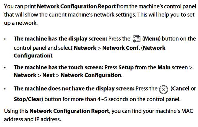

    B. Determine the IP address that is configured on the printer
    1. Do this using the printer's front panel controls.
    2. For the SCX-340xW series
    instal printer scx 3400 samsung 7defbc30-bc61-43af-b696-a56389cb089b?upload=true.png
    If the IP address reported on the printer's network configuration page is not the same as the IP address shown in the "Printer properties" dialog on your computer, follow the directions below. Otherwise, Reply here for more help. Include the IP address
