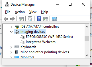

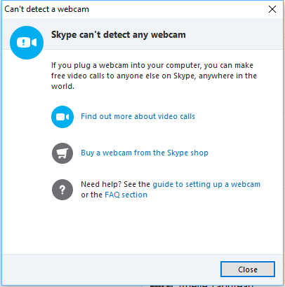

    Integrated webcam listed as hidden device in Device Manager
    I have a Dell Inspiron 15 5000 Series laptop running Windows 10. A few days ago, the built-in webcam stopped working completely. Programs like Skype, OBS, and TestWebCam all fail to detect it.
    Integrate gpu is hidden in device manager and not detected by anything 7qmHc.png
    At first, the camera appeared to be missing from Device Manager. However, after selecting View → Show hidden devices, I found my Integrated Webcam listed under Imaging Devices.
    Integrate gpu is hidden in device manager and not detected by anything 9GAW2.png
    I have tried all the steps from Dell's official troubleshooting guide:
