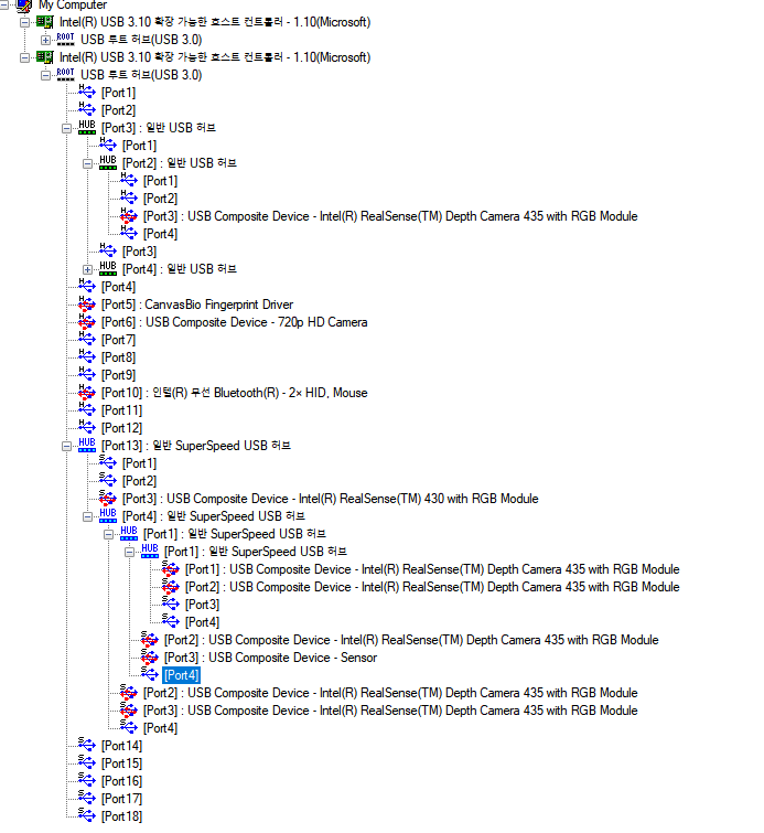

    I connected 5 usb hubs3.0 in chain mode. but last hub was detected 2.0 version. I
    So I think extensible host controller driver windows 10 usb chain limit is 4. Am i correct?
    intel usb 3.1 extensible host controller driver windows 10 usb chain limit 619be38d-a59b-41c4-b996-758745e1fa5f?upload=true.png
    jcan4545, Jun 10, 2020
