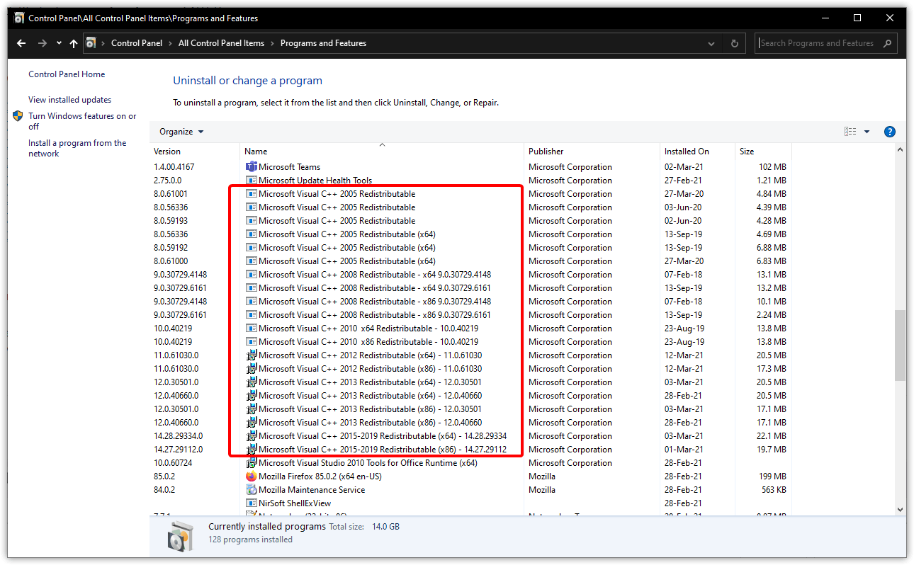

    4. Reinstalling Microsoft Visual C++ 2xxx Redistributable
    Intel wifi driver not installing dQyOBUyrYgs07A3npFsEeE5XkOj%2BLoX1hnaW2P2ZGfxs9I6bdBZp3BjfoCF0%2Bj8acqwkXNGskJYIXT6YcNYs7pVfU%3D.png
