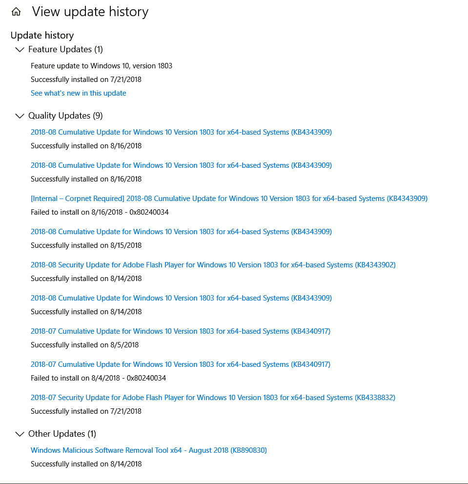

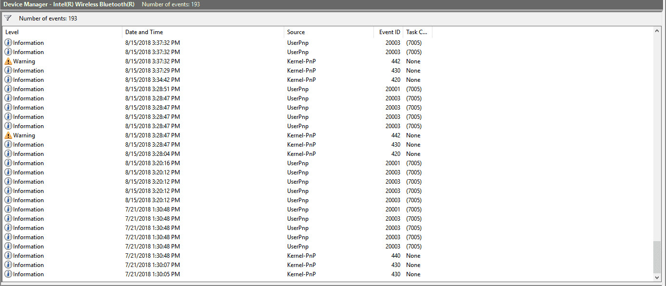

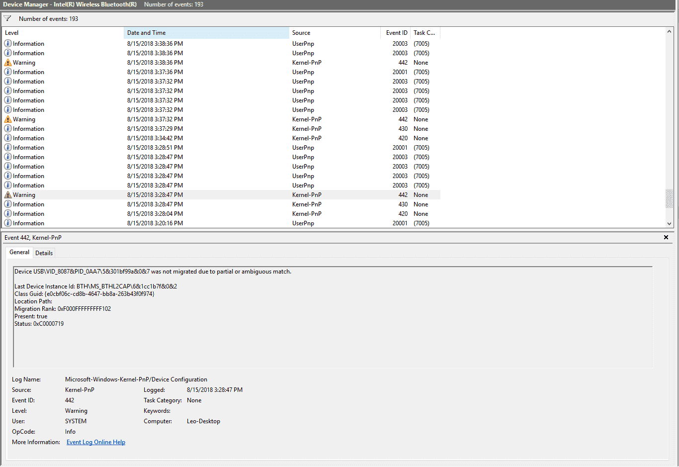

    I just bought this Desktop in July 2018 and everything works perfectly till 8/14/18 I did a Windows update, next day when I using my PC I start to realized my Bluetooth is not on, I try to turn it on but the button was missing and then I look more into it and figure out my Bluetooth driver is having a error. Please look at picture below for more info. You can see I start to get warnings on 8/15/18 after my Windows update on 8/14/18, I choose shut down and update so after update my PC didn't turn on till 8/15/18.
    My PC is Windows 10, I believe my Bluetooth comes from the Network Adaptor I'm using, which is
    Intel Dual Band Wireless - AC 3168
    Intel Wireless Bluetooth Driver Error 10 Windows update 73fa49bc-c571-45a3-949d-067dad2bfd73?upload=true.png
    Intel Wireless Bluetooth Driver Error 10 Windows update 9dd906e0-7e9f-49c8-afd0-aed5268546ba?upload=true.png
    Intel Wireless Bluetooth Driver Error 10 Windows update 0cfa6022-1e5c-4100-8edf-3a9aa9d502bd?upload=true.png
    Intel Wireless Bluetooth Driver Error 10 Windows update a6025816-151e-4e2e-a6b4-2a6102601d82?upload=true.png
    Intel Wireless Bluetooth Driver Error 10 Windows update 7c421e7b-af5d-44e2-a544-bdfb823cfff2?upload=true.png

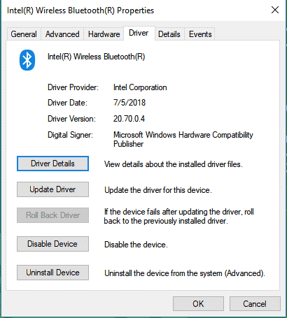

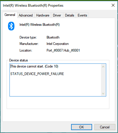

    So far I have try a lot of suggestion from the web but nothing helps.
    What I tried so far:
    1. Update my driver to the newest (it already on the newest)
    2. restore my pc to a earlier point
    3. uninstall windows update
    4. go to service.msc restart Bluetooth support service and set it to auto
    5. uninstall and reinstall driver
    6. using windows troubleshooting, Bluetooth and hardware both didn't fix problem
    7. Change to Generic Bluetooth driver (gives me error code 43, when update it brings me back to Intel's latest version, which is what I had)
    If anyone has a fix please help! Microsoft please fix this!!! I Bought a $200 wireless Earbud just for wireless and the reason why I bought this PC it also because I want Bluetooth connection!
    Thanks!

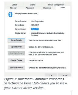

    • Right-click “Intel(R) Wireless Bluetooth(R)” and select Properties.
    • Click the Driver tab and check the Bluetooth driver version.
      (See Figure 1.) If your driver version is 19.50 or greater, you are not experiencing this issue. If your Bluetooth driver version is newer than 19.0 but older than 19.50 continue to the next section.

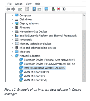

    Update your Intel Wi-Fi driver version to 20.50+
    • In Device Manager, expand Network adapters and locate your wireless controller.
      • If you’re using having trouble identifying the name of your Wi-Fi controller you can also check its name using
        this tutorial
    • Right-click your Wi-Fi controller (see Figure 2) and select
      Properties
    Intel Wireless Bluetooth Driver Error 10 Windows update 7cef55cc-9c97-435a-8835-f2766d8fd6f4?upload=true.png

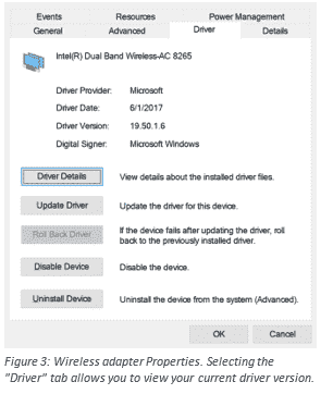

    3. Click the Driver tab to check your Bluetooth driver version. (See
    Figure 3.)
    Intel Wireless Bluetooth Driver Error 10 Windows update f185ef39-8434-4bb6-b720-9839a1d8c71b?upload=true.png
    • Click the Driver tab and check the Bluetooth driver version. (See Figure 1.)
    • If your driver version is older than 19.50, click Update Driver and select
      Search Automatically. Windows will automatically install the latest driver version for available for your Bluetooth radio.
    • If Windows installs Bluetooth driver version 19.50 or newer in the previous step, perform a cold boot as described in Part 3, and you’re all set.
