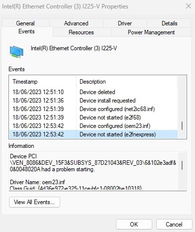

    I've had a MAJOR issue with my Ethernet Adaptor for the past 2 weeks and I've tried just about EVERY method I know and could find online to try and fix but to no avail, the issue is that the Ethernet Adaptor works perfectly fine in normal use but as soon as I launch a game such as BF2042 or For Honor my Ethernet completely stops working and the only way to fix it is by restarting my PC as trying to do anything with it in Device Manager either crashes the system or gives an infinite loading status.
    The issue seems to come from Windows refusing to configure my adapter properly because I noticed it says "Device not started (e2fnexpress)" when the Intel provided drivers are installed or "Device not started (e2f68)" when the default Windows drivers are installed but I've done everything that should've resolved this issue and yet it persists...

    I've ordered a new PCIe NIC in hopes it'll resolve the issue if I just bypass using the onboard NIC, I'll update this once I've tried it out.
    Tried Methods:
    Updated Motherboard Bios
    Used Different Ethernet Cable
    Reset Router
    Installed Replacement Motherboard
    Reset Ethernet Adaptor Settings
    Updated Intel I225-V Drivers
    Uninstalled Intel I225-V Drivers
    Run Troubleshooter
    Run SFC /SCANNOW
    Reset Winstock
    Flush IPConfig
    Complete Reinstall of Windows 11
    Complete Reinstall of Windows 10
    Installed New SSDs
    Installed New CPU

    Name [00000001] Intel(R) Ethernet Controller (3) I225-V
    Adapter Type Ethernet 802.3
    Product Type Intel(R) Ethernet Controller (3) I225-V
    Installed Yes
    PNP Device ID PCI\VEN_8086&DEV_15F3&SUBSYS_87D21043&REV_03\6&102E3ADF&0&0048020A
    Last Reset 18/06/2023 12:54
    Index 1
    Service Name e2fnexpress

    Driver C:\WINDOWS\SYSTEM32\DRIVERSTORE\FILEREPOSITORY\E2FN.INF_AMD64_E9EA266A76AD019B\E2FN.SYS (2.1.1.7, 1.30 MB (1,360,080 bytes), 07/02/2022 06:21)
