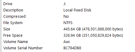

    Windows Update Breaks Connection to Secondary Internal SSD
    Frequently running Windows Update will cause my secondary internal SSD to be uninstalled and not visible to Device Manager... or any other software. Sometimes an ordinary re-boot will solve the problem. Other times the latest update must be backed out to correct the problem. This breakage has happened at least 3 times this year.
    When Windows Update causes this problem, nothing can access the SSD. It cannot even be uninstalled, because it doesn't show up in the device list. When corrected, the drive is recognized as usual.
    The problem has always been resolved without opening the computer box.
    Drive: Internal Crucial (Micron) M500 SSD.
    All indications show the drivers are current. The current driver is Microsoft 6/21/2006 version 10.0.19041.789
    Windows 10.0.19042 Build 19042
    Dell XPS 8940 Desktop Computer
    Here is how System Information describes the secondary SSD
    Internal SSD secondary not the one which has windows installed is randomly disappearing... 346901d1632456105t-windows-update-breaks-connection-secondary-internal-ssd-ssd.png
    compupix, Sep 23, 2023
