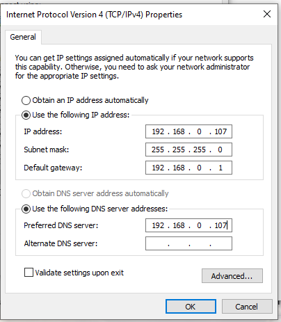

    I'm trying to set up Windows Server 2019. I've set static IP on server machine192.168.0.107. And When I give the same IP for DNS server. Internet stops working. Both the static IP192.168.0.107 and DNS server IP192.168.0.107 should be the same, shouldn't it? When I give the Google/Router DNS. Internet works fine. but not when I set it to 192.168.0.107. What am I doing wrong??? Internet stops working when I change DNS Server IP on Windows Server 2019 c13b1543-5f45-4dba-900a-1939d9b8b979?upload=true.png

    So far, it seems like I got it fixed. I disabled Advanced DNS Service and DNS Relay. I put in the two DNS server IPs I listed above into the internet configuration and rebooted it.
    FordGT90Concept, Mar 17, 2021
