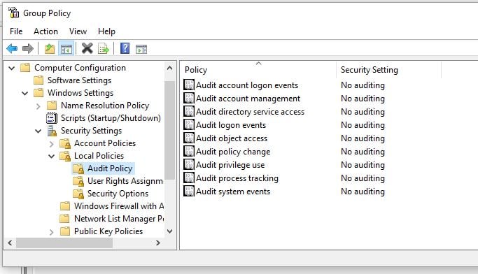

    Disable auditing of successful events
    I want to disable auditing of successful events!
    This command worked (at least CMD said it did) Code:
    I need to check in event log, if there are reported any longer successful events. Problem is: overall there are too many categories to check manually!!!
    So i ran this command: Code:
    And i got:
    System audit policy
    Category/Subcategory
    "No auditing" for all categories!
    which is strange for 2 reasons:
    - i have auditing, minimally of failure events
    - there should be now auditing only for successful events...
    Also in local security policy program, there is under local policy/audit policy no auditing!
    While in Event Viewer i have literally under: Windows logs/Security listed events with name Audit success! So auditing had to be on! And this is even stranger, in local security policy program, i have not configured under Advanaced Audiot Policy Configuration/System Audit Policies - Local Group Policy Object. Which should be same category as by that command i used in cmd. And i had there not configured before. Which doesn't exclude auditing, if it is configured elsewhere.
    Difference is i have, in what should be same category, no auditing, if i use that command in CMD! But in local security policy program: i have not configured. Which contradicts itself!
    Now i am confused, what is what?!
    EDIT:
    Even that command executed successfully. I have still audit success in Event Viewer. Windows logs/security in particular. Anyone help? How do i disable auditing of successful events for every category?
    THANKS!
    Solved:
    After some more googling, i found, which category is related to security events. And you can't probably disable logging of only successful events for this category.
    I created custom view and for any other category, there are no successful events. So command: auditpol /Set /Category:* /success:disable should be working!
    empleat, Aug 17, 2024

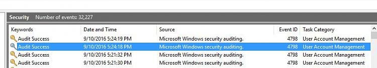

  4. Is it normal for the audit success message to trigger multiple times a second in event viewer?
    Too Many 'Audit Success' Security-Auditing Events Happening
    Thanks again. The sounds not the real issue (just helped me identify what was going on) it's the fact that the machine effectively locks up for a few seconds every time it happens. I re-posted below as JPEG
    Is it normal for the audit success message to trigger multiple times a second in event viewer? 100843d1485971714t-too-many-audit-success-security-auditing-events-happening-capture-2.jpg
    Is it normal for the audit success message to trigger multiple times a second in event viewer? 100844d1485971714t-too-many-audit-success-security-auditing-events-happening-capture.jpg
    jacobjingle, Aug 17, 2024
