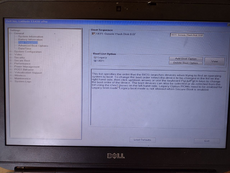

  2. No drive found on my internal hard disk on Dell Latitude E5430.

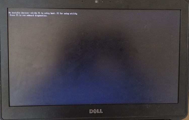

    Hello,My laptop (Dell Latitude E5430) was working perfectly till yesterday. But yesterday night, it restarted on its own and ever since, it's stuck at this screen:
    Is it possible for me to run windows 11 on my Dell latitude E5430, RAM 8GB, 250 HDD 325596d1617341188t-no-drive-found-my-internal-hard-disk-dell-latitude-e5430-image.png
    Also, inside the BIOS, no UEFI bootable hard disk drive is being listed.
    Is it possible for me to run windows 11 on my Dell latitude E5430, RAM 8GB, 250 HDD 325602d1617343301t-no-drive-found-my-internal-hard-disk-dell-latitude-e5430-image.jpg
    The UEFI flash disk option shown above is that of my bootable pen drive with Windows 10 installation copy.I googled this issue a bit and the results were as follows:

    In a nutshell, while the hard disk is being detected, but none of its drives is. However, the hard disk consisted of 3 drives:

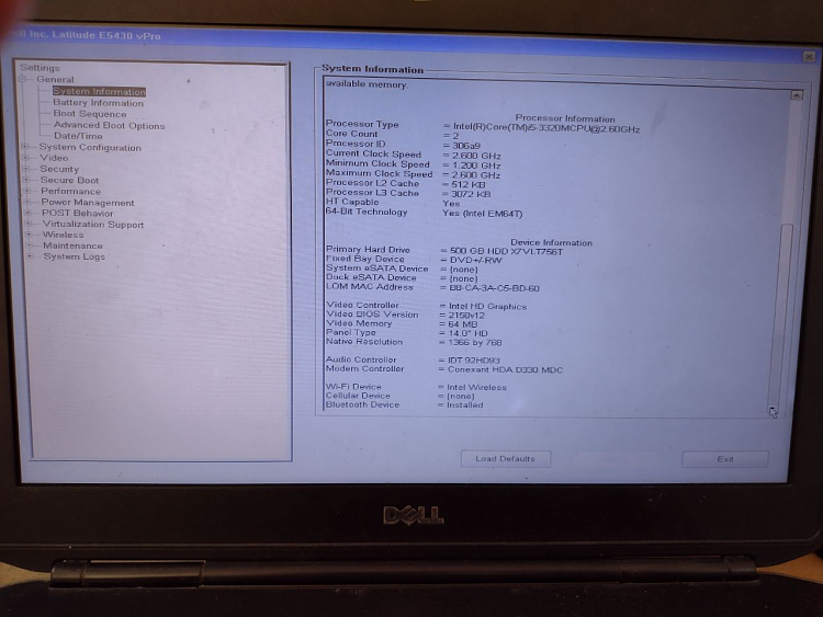

    1. I did reset my BIOS by clicking the Load Defaults button. But no luck with that.
      Is it possible for me to run windows 11 on my Dell latitude E5430, RAM 8GB, 250 HDD 325619d1617357894t-no-drive-found-my-internal-hard-disk-dell-latitude-e5430-image.png
    2. The system information is as follows. It does detect the Toshiba SSHD..

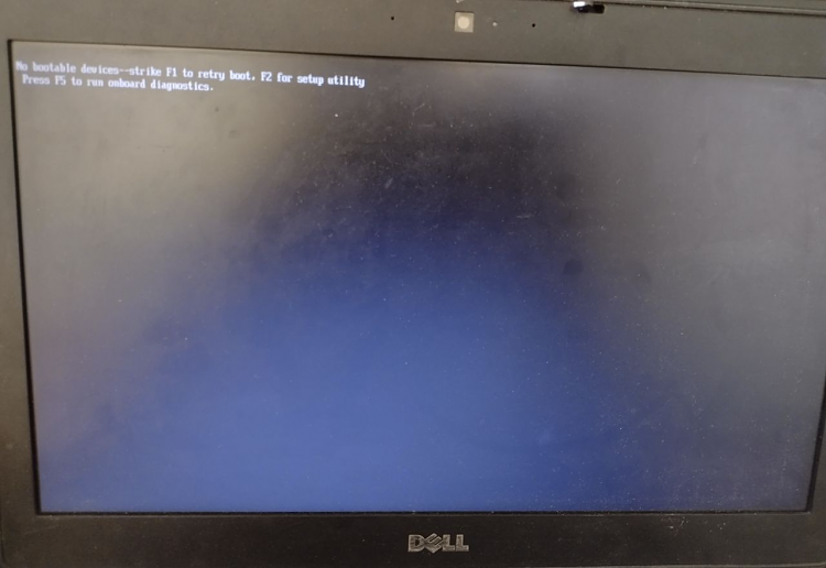

    1. When I boot using the UEFI Boot List option, the BIOS is as follows:
      Is it possible for me to run windows 11 on my Dell latitude E5430, RAM 8GB, 250 HDD 325625d1617354813t-no-drive-found-my-internal-hard-disk-dell-latitude-e5430-image.png
      and the laptop gets stuck at this screen:
      Is it possible for me to run windows 11 on my Dell latitude E5430, RAM 8GB, 250 HDD 325624d1617360682t-no-drive-found-my-internal-hard-disk-dell-latitude-e5430-image.png

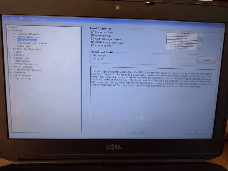

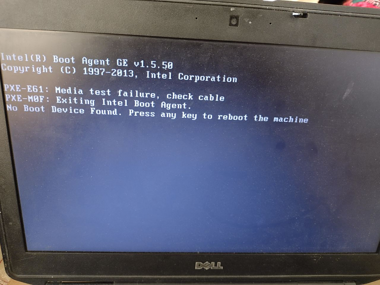

    2. When I boot using the Legacy Boot List Option, the BIOS is as follows:
      Is it possible for me to run windows 11 on my Dell latitude E5430, RAM 8GB, 250 HDD 325623d1617360660t-no-drive-found-my-internal-hard-disk-dell-latitude-e5430-image.png
      and the result is as follows:
      Is it possible for me to run windows 11 on my Dell latitude E5430, RAM 8GB, 250 HDD 325626d1617360780t-no-drive-found-my-internal-hard-disk-dell-latitude-e5430-image.png
    And I don't get to press and hold the power button in either case. The laptop turns off as soon as I press the power button in either case.

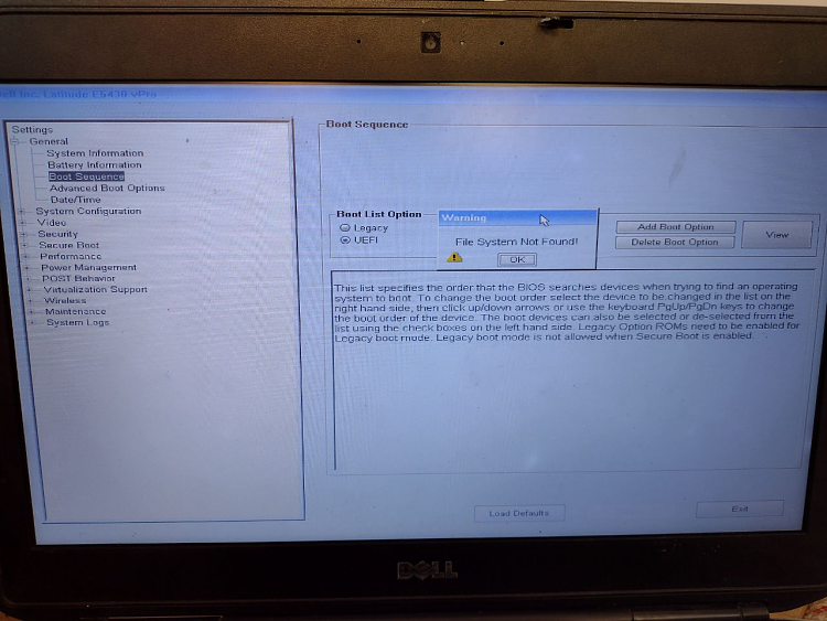

    dalchina,
    Regarding the possibility of having lost the partition table, I have to show you this:
    Is it possible for me to run windows 11 on my Dell latitude E5430, RAM 8GB, 250 HDD 325634d1617362983t-no-drive-found-my-internal-hard-disk-dell-latitude-e5430-image.png
    This is shown when I click Add Boot Option in the UEFI mode.
    Earlier, when the Toshiba SSHD was working fine, in the Boot Sequence, the Hard Disk option used to be shown, instead of the blank space being shown now.
    Also, when I updated my windows to 20H2, I got "Invalid Partition Table!" error once. I resolved it by restoring the BIOS to defaults and then changing the Boot Sequence from Legacy to UEFI mode.
    Ten64BitUser, Oct 3, 2024
