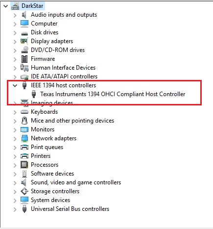

  4. wvlucas Win User
    is my firewire port card working?
    Does Windows 10 Pro x64 support Firewire adapter?
    I learned Windows 10 does support firewire. A 3 port firewire 1394B & 1394A PCIe card
    adapter was installed and sure enough, the system does recognized the device. The device manager lists the firewire adapter as, "Texas Instruments 1394 OHCI Compliant Host Controller." The firewire device supports both 800 or 400 Mbps. A
    HD camcorder (Canon HV20) connected to either 1394a or the 1394b port and was tested, both 1394a and b worked.
    So to answer my own question, yes, Windows 10 supports firewire.
    wvlucas, May 7, 2020
