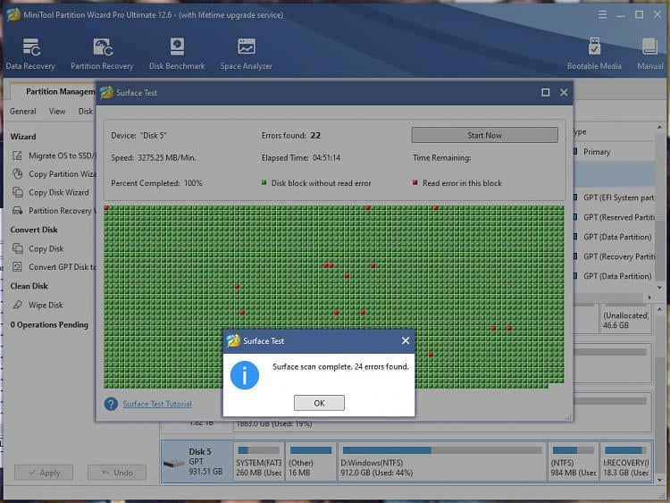

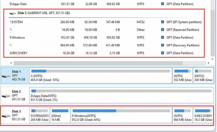

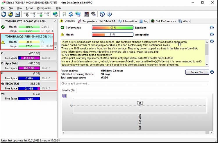

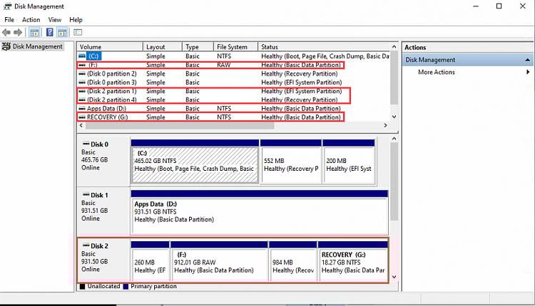

    I'm just posting the screenshots you asked for here.
    Posted on HP Community for explanation to the code error, waiting for answer.
    Is my HDD dead? 357282d1642269101t-suspected-dead-hdd-2022-01-15_17-06-12.jpg
    Disk Management
    Is my HDD dead? 357283d1642269218t-suspected-dead-hdd-2022-01-15_17-08-29.jpg
    MiniTool Wizard Partition Tool
    HD Sentinel
    Is my HDD dead? 357285d1642269530t-suspected-dead-hdd-2022-01-15_00-34-53.jpg
    Surface Scan

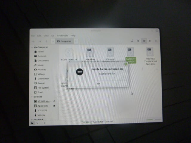

    @steve108
    Booted Ventoy/Linux Mint > Computer but the HDD would not mount! *Mad
    Linux Mint
