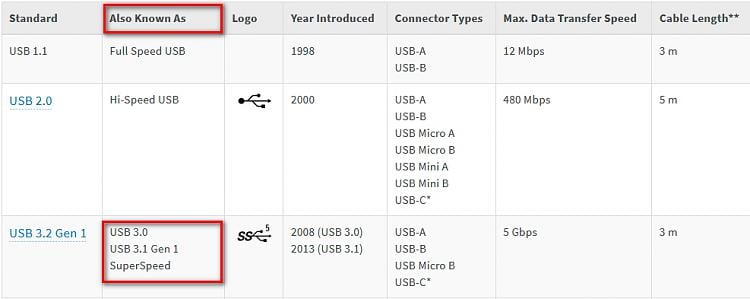

  4. SIW2 Win User
    Is my motherboard alergic to USB 3.1 Gen 2?
    USB 3.2 Gen 1 Type-A Module
    Why? They are the same speed. According to the motherboard diagram that socket numbered 9 is usb 3.2 gen 1, which is the same as usb 3.0
    Is my motherboard alergic to USB 3.1 Gen 2? 351699d1637073555t-usb-3-2-gen-1-type-module-usb3-speeds.jpg
    USB: Port Types and Speeds Compared | Tripp Lite
