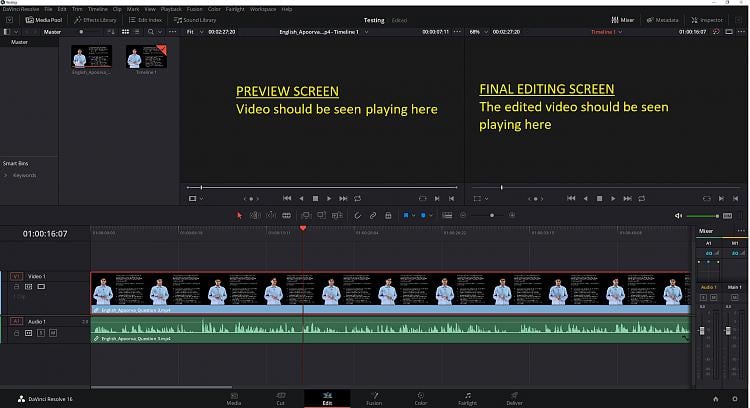

    I want to run a software called DaVinci Resolve (its an editing & grading software). The problem is that the software is not playing/previewing video footage, it shows a black window instead of showing the video being played.
    IS Nvidia VGA Drivers the same as Game Ready/Studio Drivers? d1567112884t-error-updating-intel-hd-vga-driver-nvidia-studio-drivers-davinci-resolve-screenshot.jpg
    When I posted this issue to DaVinci Resolve team, they suggested me to update my Intel HD VGA driver for motherboard & NVIDIA STUDIO drivers & then check if this solves the issue.

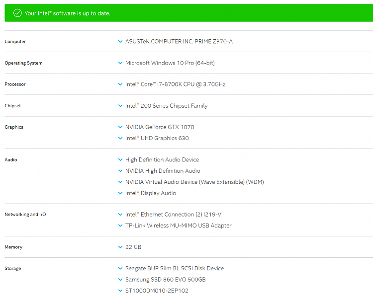

    I downloaded the Intel VGA drivers from:
    PRIME Z370-A Driver & Tools | Motherboards | ASUS USA
    But when I ran the setup file, it gave me the following error:
    The driver being installed is not validated for this computer.
    Please obtain the appropriate driver from computer manufacturer.
    Setup will exit.
    This error took me to Intel® Driver & Support Assistant, which scanned my system and told me that my intel software is up to date. I have attached the intel driver detailed report.
    Then I installed the NVIDIA STUDIO driver & updated the drivers.
