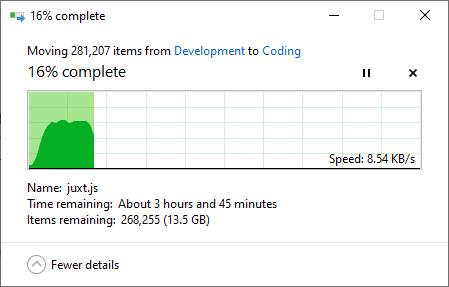

    I'm having a hard time finding which USB ports on my laptop and its dock are v3 or v2 (or less possibly), but when I tried two different ports (I think one is v3), they both seemed to transfer at about 150KBps... which seems slow even for USB v2.
    I'm copying files from an older hard drive (connected externally) to my backup drive partition (through the dock), and right now it's transferring at about 8KBps... now, there's a crap ton of little files in there because a lot of them came from coding sessions, and many of them I'm not even aware of because they're either from downloads I made or git repos or npm packages etc; I don't know if that really slows down the transfer rate, but maybe.
    Is there any way to improve file transfer speeds between my hard drive and a USB stick? 1614561573t-usb-transfer-speed-external-hard-drive-external-hard-drive-usb-transfer-speed-coding.png
    Can someone enlighten me on why this doesn't seem to be anywhere near even halfway to USB 2 max speeds? I understand max speed will probably never happen, but I'm miffed at how slow it's going.

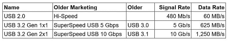

    Three points:
    • The speeds are given in Gb/s while test results are MB/s. See table.
    • The rates speeds are maximum theoretical. Real world speeds might be 80-90% of that.
    • The rates 5Gb/s speed is for the USB controller. It might be shared among multiple USB ports.

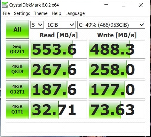

    SATA and NVMe SSDs internally are faster. Externally in enclosures their speeds are limited by the USB interface. The NVMe external SSD is faster with USB 3.1 but is still not as fast as it would be internally The following show internal SSD speeds ADATA SU800 M.2 SATA SSD (1TB)
    Is there any way to improve file transfer speeds between my hard drive and a USB stick? 403215d1704858773t-faster-transfer-usb-stick-nvme-drive-enclosure-ps0970.jpg

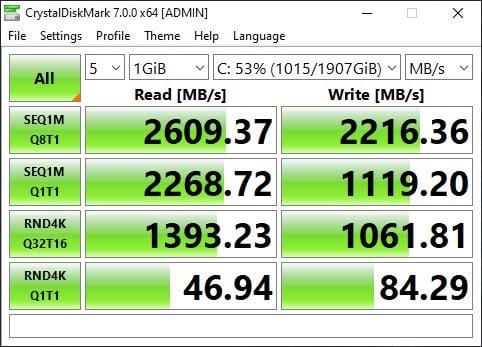

    ADATA SX8200PNP M.2 NVMe SSD (2TB)
    Is there any way to improve file transfer speeds between my hard drive and a USB stick? ter-transfer-usb-stick-nvme-drive-enclosure-2021-03-30-23_49_45-crystaldiskmark-7.0.0-x64-admin-.jpg
